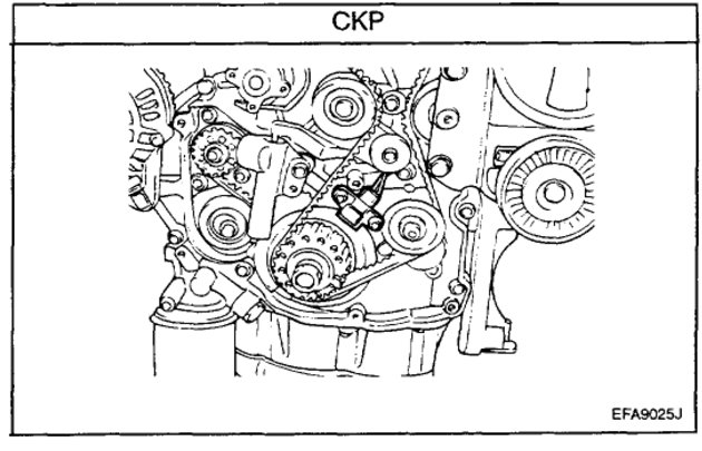

Yes, that can cause the problem for sure. Here is a guide to show you what you are in for and some diagrams below to help you get the problem fixed.

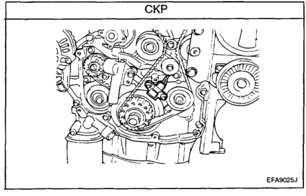

Crumbs! P0335 is crankshaft not camshaft sensor. I wrote wrong one! I gather this can cause the problem too!
Jul 24, 2017 at 5:14 PM
No problem,
Here is a guide and the location of the sensor. The guide will give you an idea of what you are in for when doing the job.
