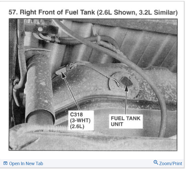

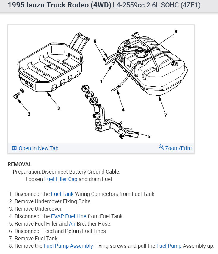

No diesel to the rail means the primary pump in the tank is not working. Most of the time its the pump or relay that is causing the problem here is a guide to help you see what you are in for when changing the pump out and diagrams below to show you on your car.
Check out the diagrams (Below). Please let us know what happens.
