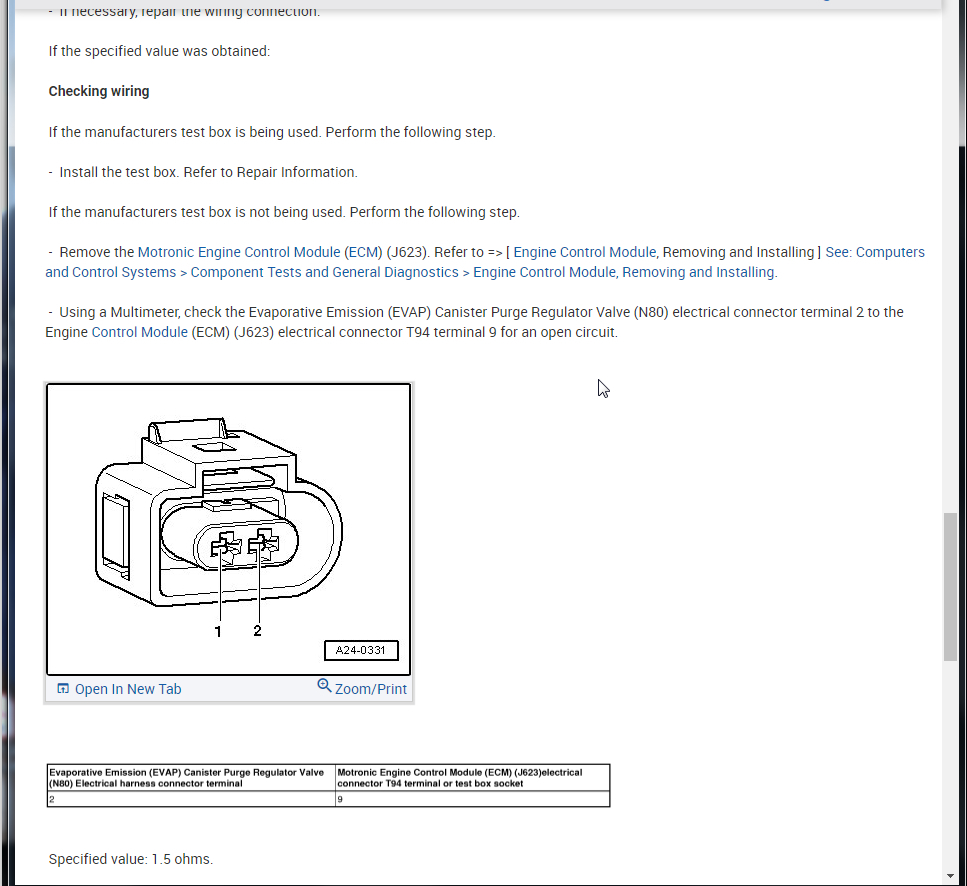

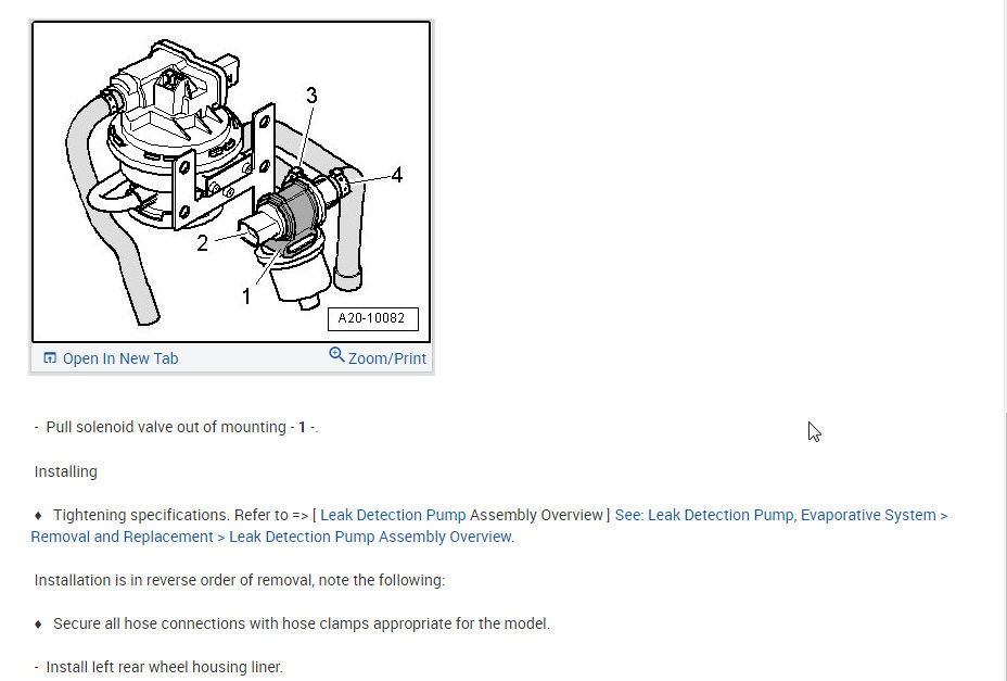

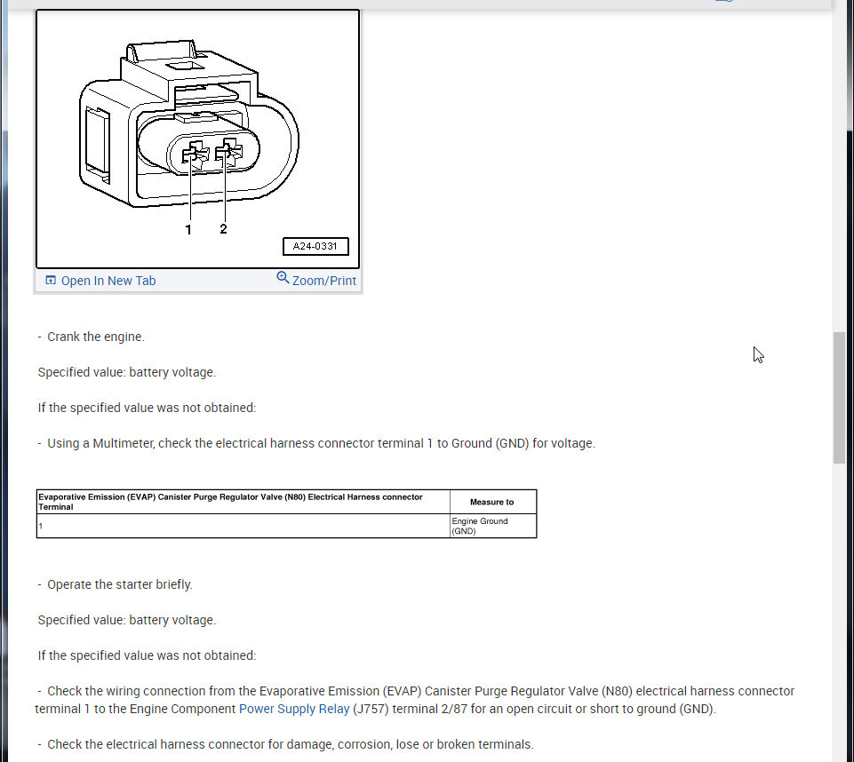

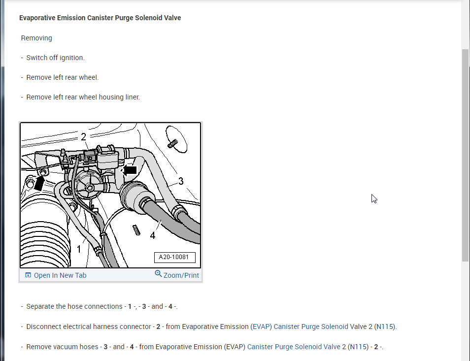

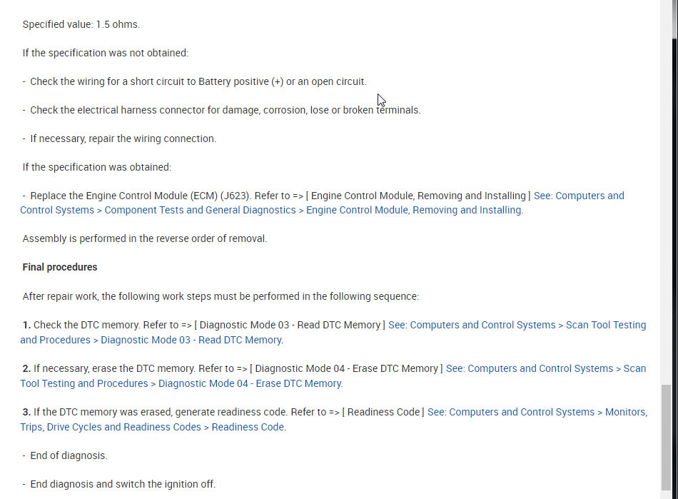

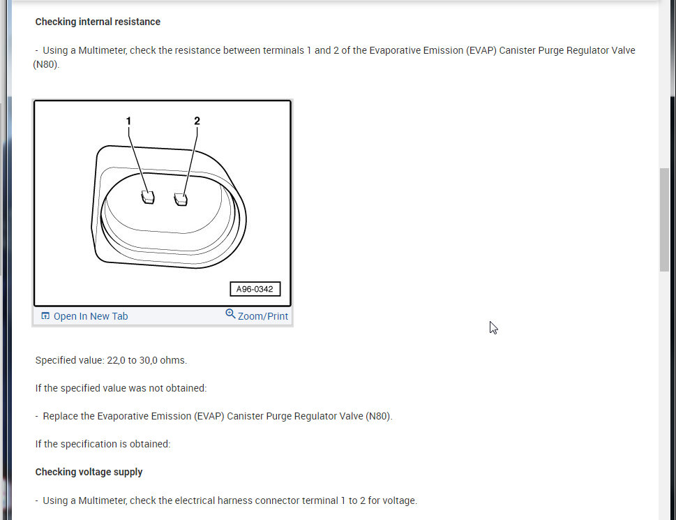

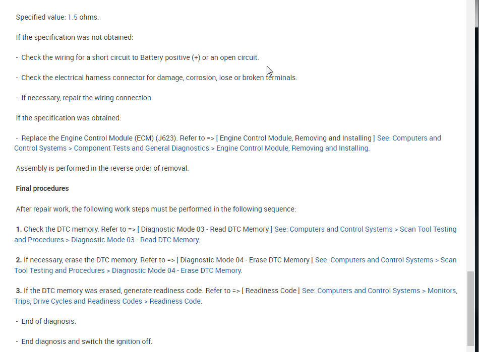

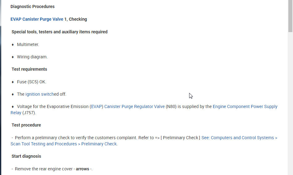

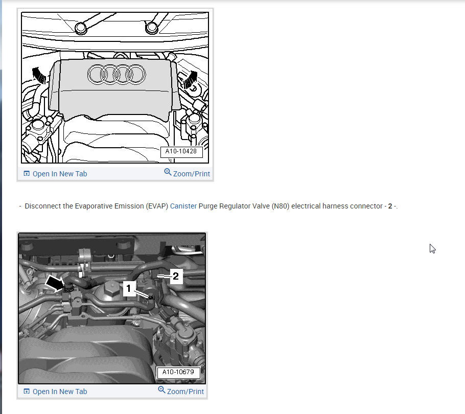

I attached the process below on how to replace this or test this if you would like to confirm it.
