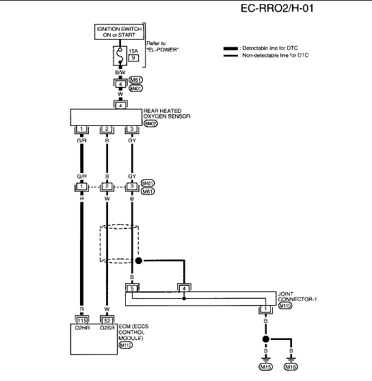

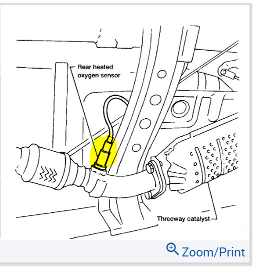

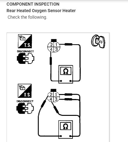

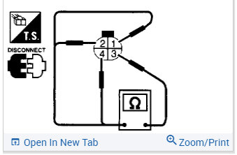

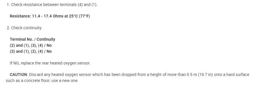

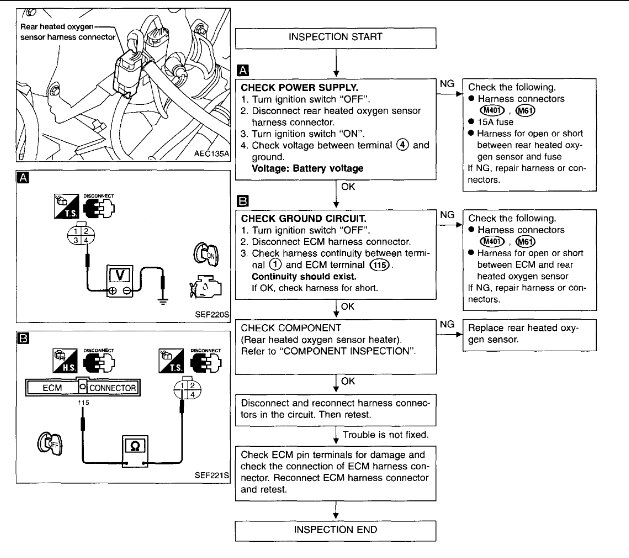

I just replaced the timing chain and now it will crank and run. However, after the engine warms up it is like it is running out of gas. It also appears to be draining a fully charged battery when this occurs because it will not restart until battery is recharged. It cranks and idles normally and i can hear the fuel pump coming on when the key is turned.
