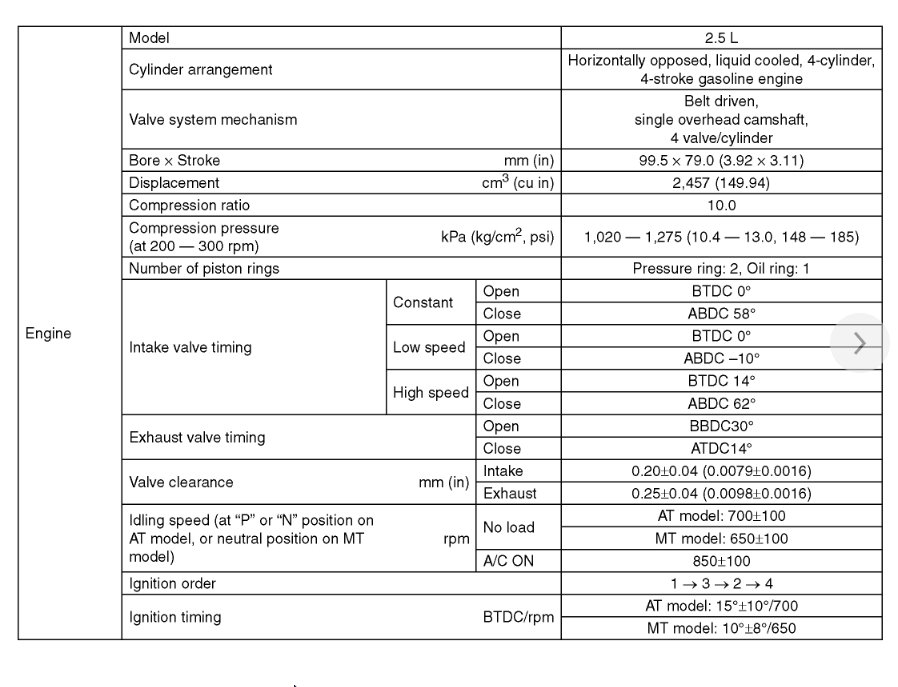

Was getting on highway and stepped on it to pass a vehicle. As pass was complete the car shut down. Pulled onto shoulder and tried to start, which it did one time but shut down whe put into gear. Had to be towed took to house. After removed from rollback driver tried to start and stated possible timing issue. Need direction to start looking as I am not planning on taking to a garage.
