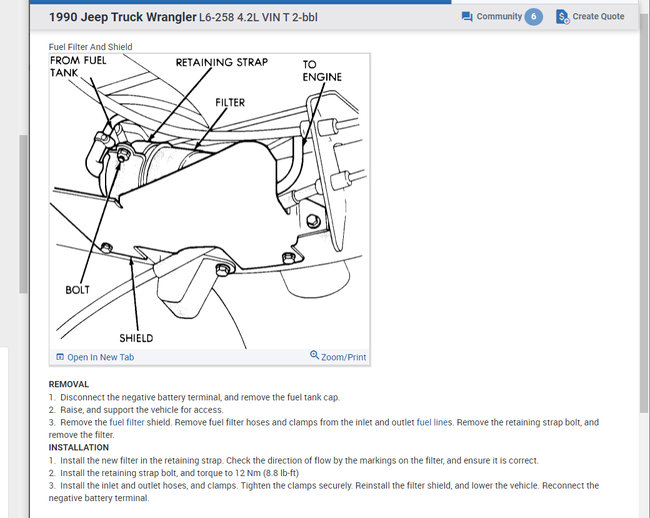

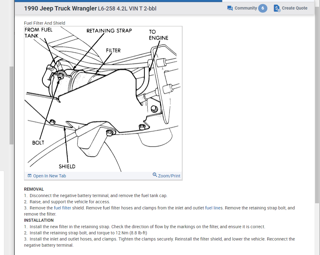

You said that you removed the air cleaner from the throttle body, however, the 4.2L has a carburetor so I assume this is what you are meaning but I just want to make sure we are on the same page.

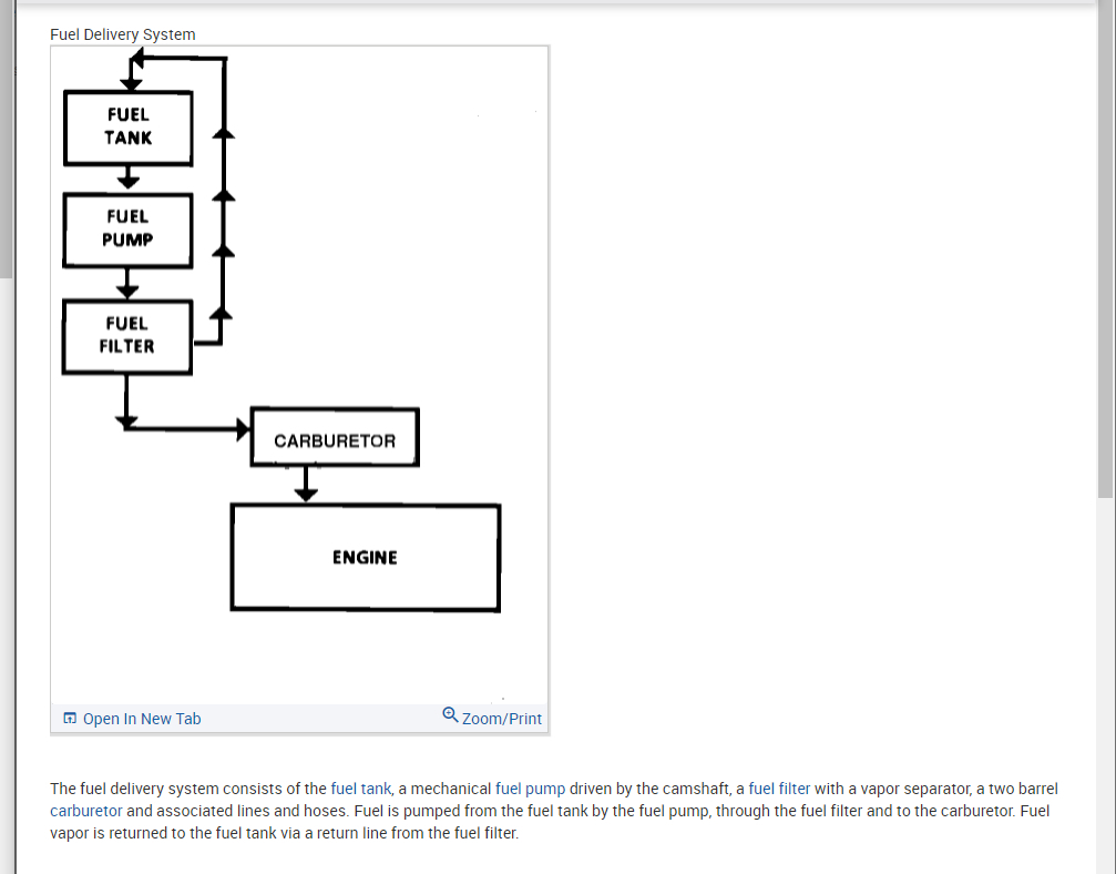

So, if this is the case then I would suggest starting with checking the fuel filter if you are not getting fuel to the carburetor.
The best way to start is to use starter fluid on in the carb and see if it fires for a second.
If it does, remove the filter and make sure it is not clogged. On this engine, when the filter gets clogged, it will just route the fuel back to the tank if it moves it at all.
https://www.2carpros.com/articles/how-to-change-a-fuel-filter
I included the info below for this so let's start with this and find out for sure if this is a fuel issue and we can go from there.
