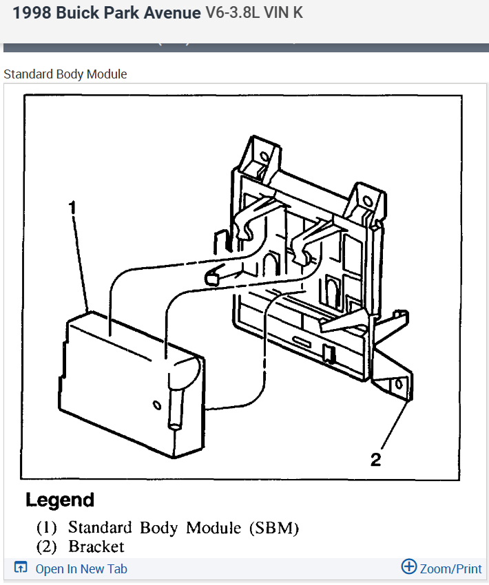

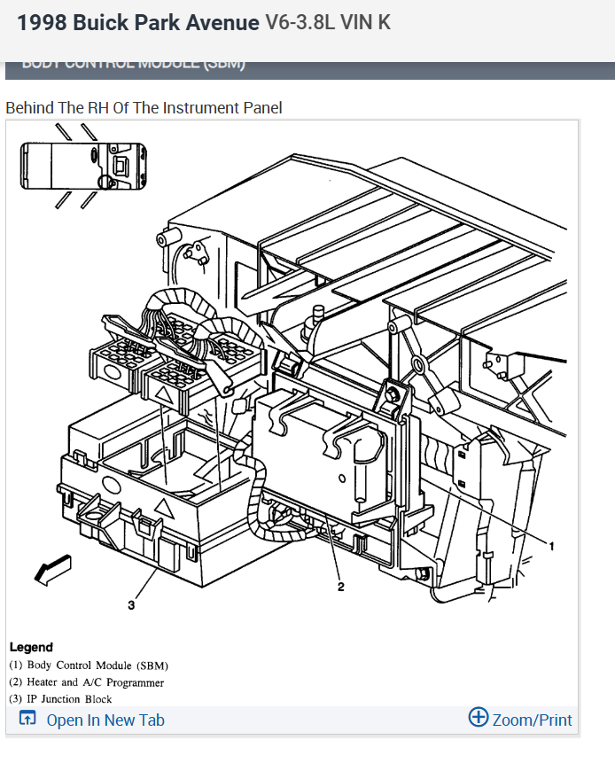

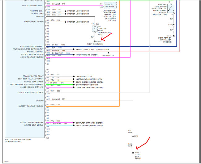

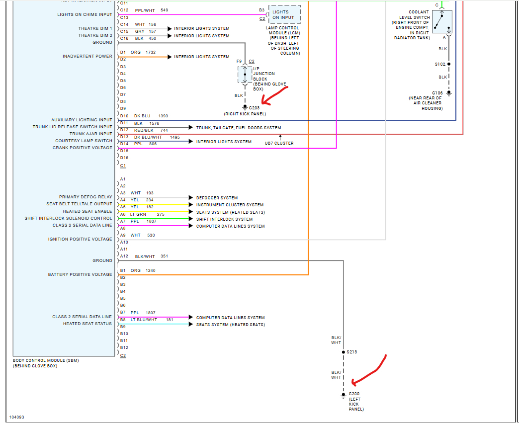

I have down some research and the BCM is the only component that tries these systems together. If all fuses are good, (key on) this guide can help:
Then I would check the BCM ground, which is at the right and left kick panels, also I would try a CAN scan which they did not have back then which can help tell you what the problem is. You can get a CAN scanner (Controller Area Network) which will work on most cars from Amazon.
Here is a video to show you how:
https://youtu.be/u-4syLc-ifQ
Here is the location of the BCM so you can check it out, I would check it for water damage. Check out the images (below). Please upload pictures or videos in your response of any problems so we can see what to help you with.
