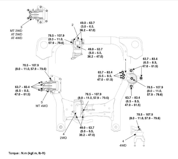

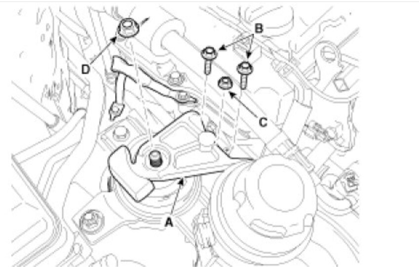

If they had the engine out, it should be their responsibility to check things such as mounts. Also, if they were good prior to the work, they don't just go bad for no reason. It is possible that something was left loose.
Also, an engine mount shouldn't affect handling. It could cause a vibration, and the chances of all of them needing to be replaced (because they all went bad at the same time) is extremely unlikely.

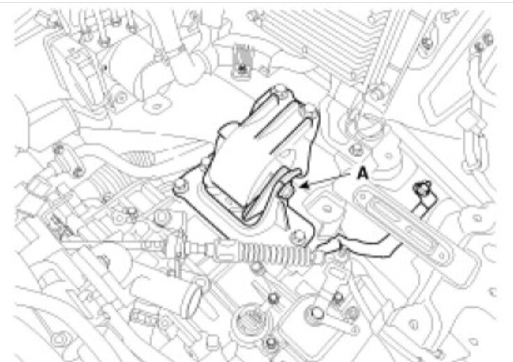

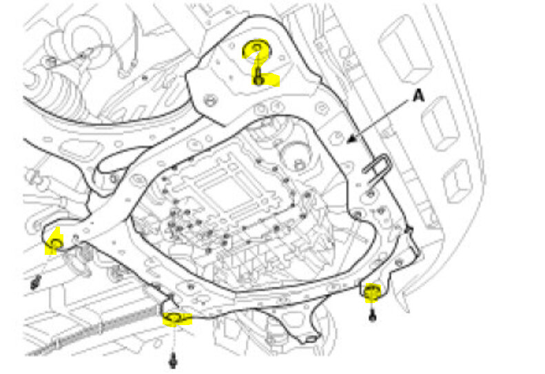

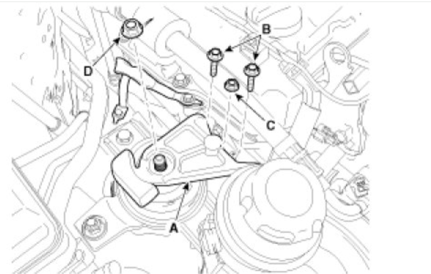

Take a look below at the pics I attached. Make sure the mounts are tight and check to see if there is any damage to the mounts. Additionally, make sure the engine support under the engine bolts are tight.

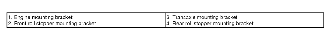

Pic 3 below shows the sub-frame bolts. The remaining pics are to help you locate/identify mounts.
joe
See pics below.
