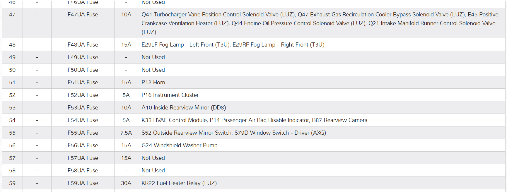

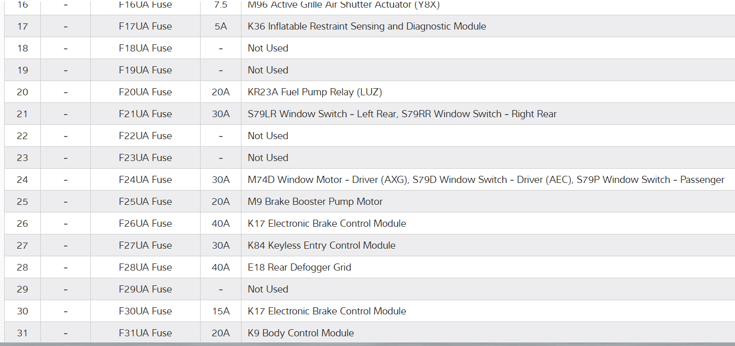

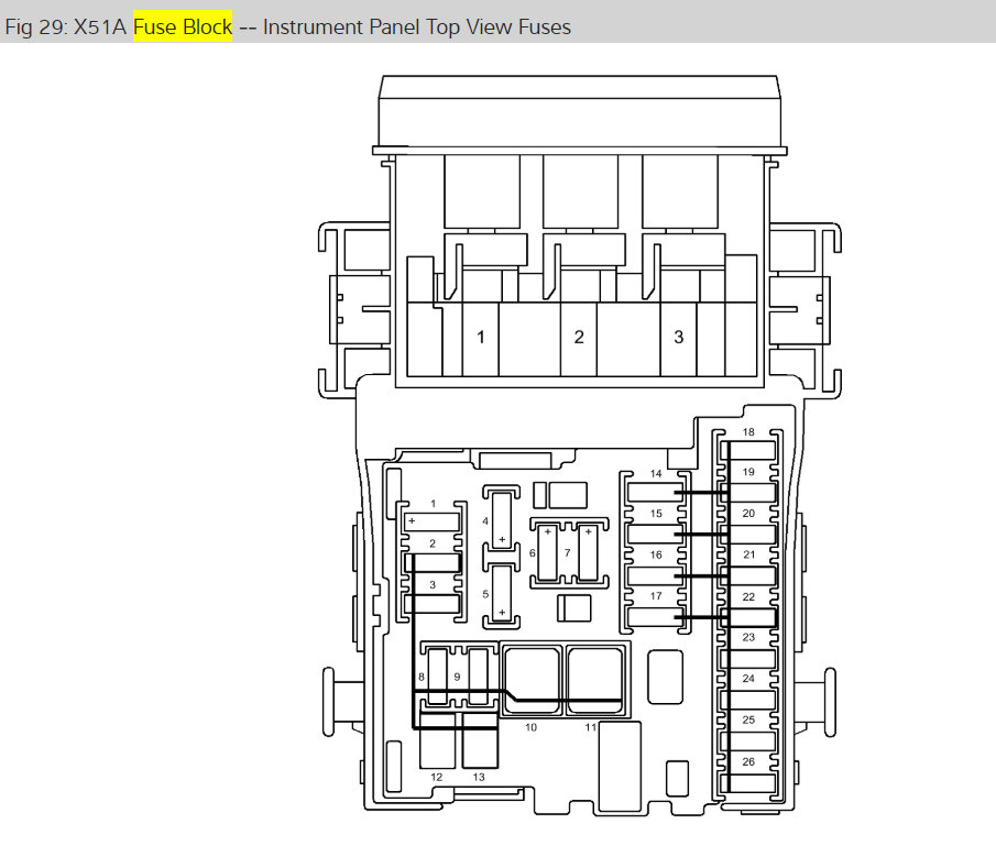

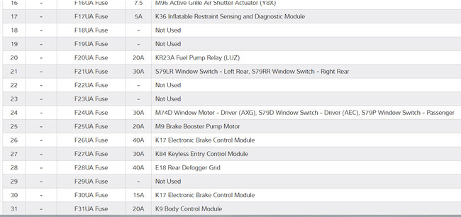

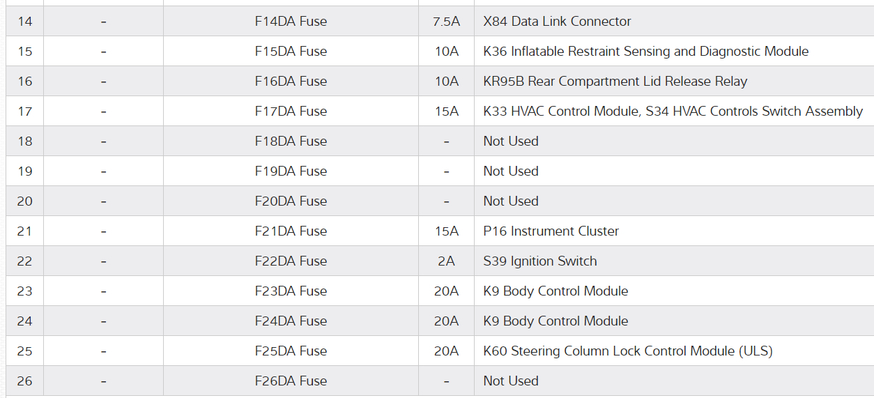

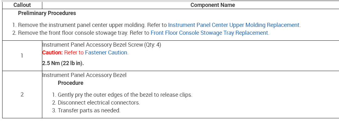

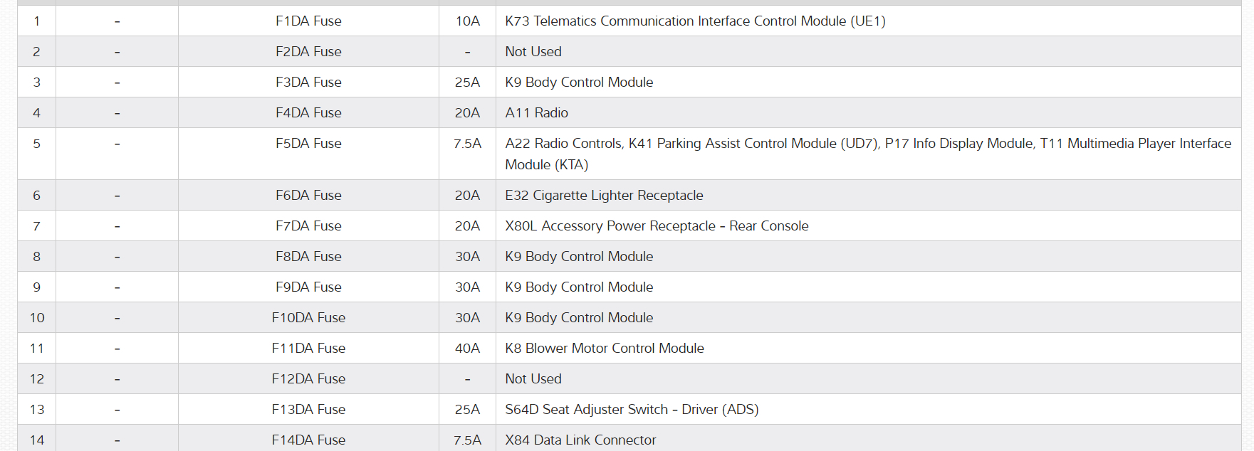

I pulled the #52 fuse it is good what else can I do? The DIC works i just can't change anything.
Jun 20, 2019 at 11:00 AM
CERTIFIED EXPERT
53,854 POSTS

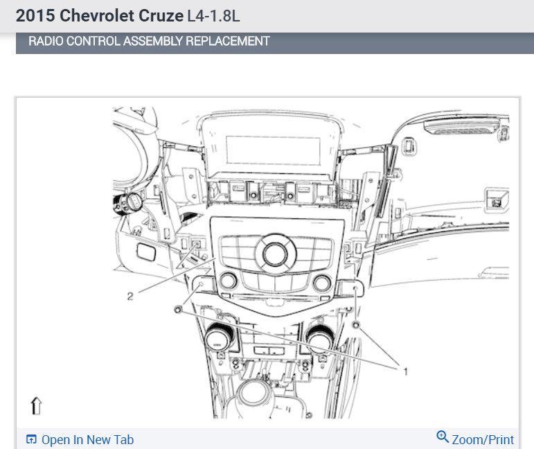

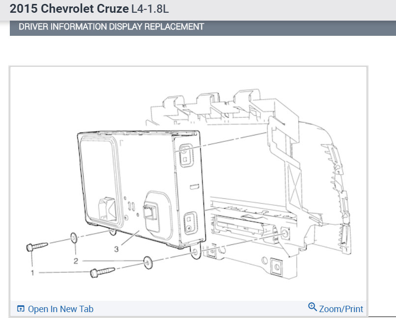

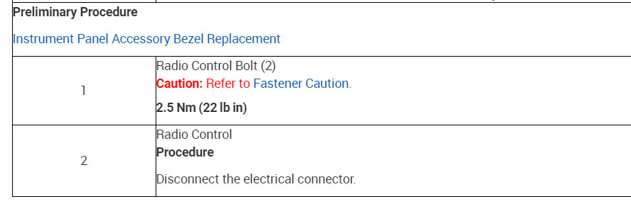

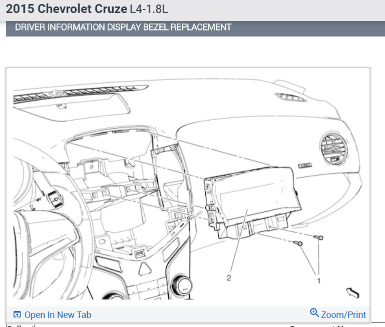

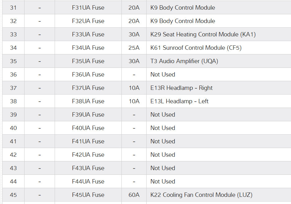

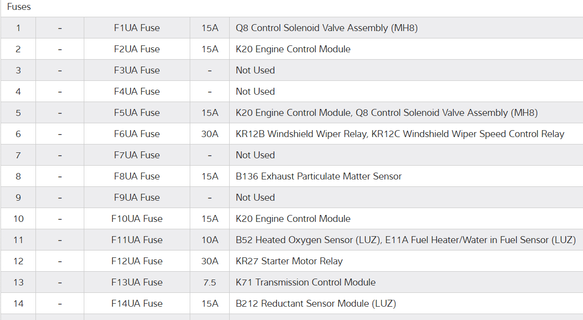

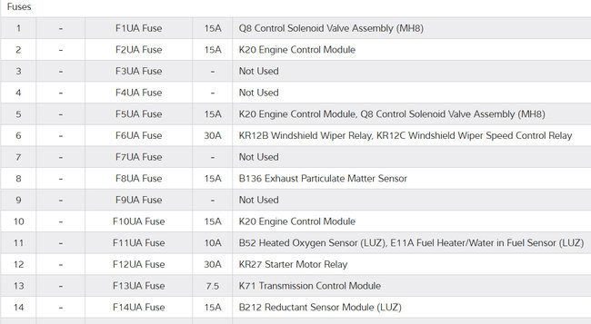

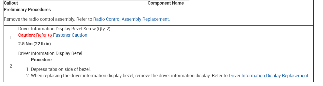

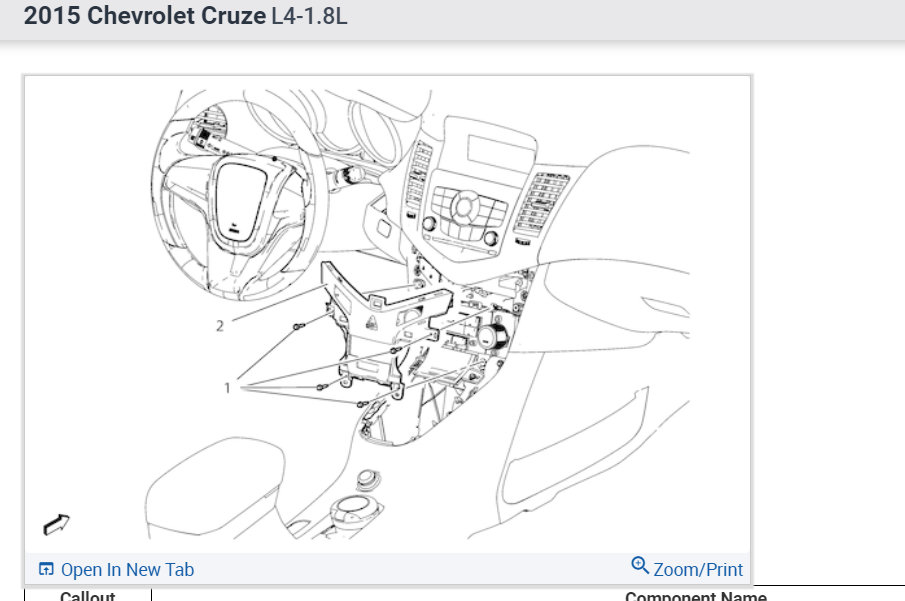

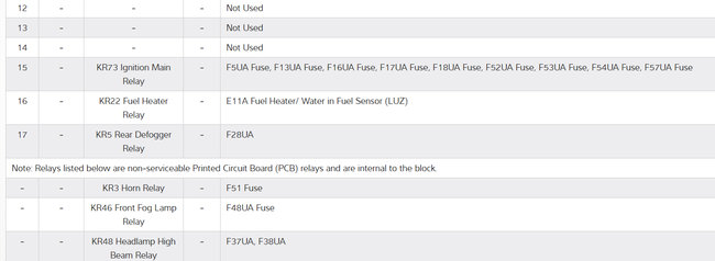

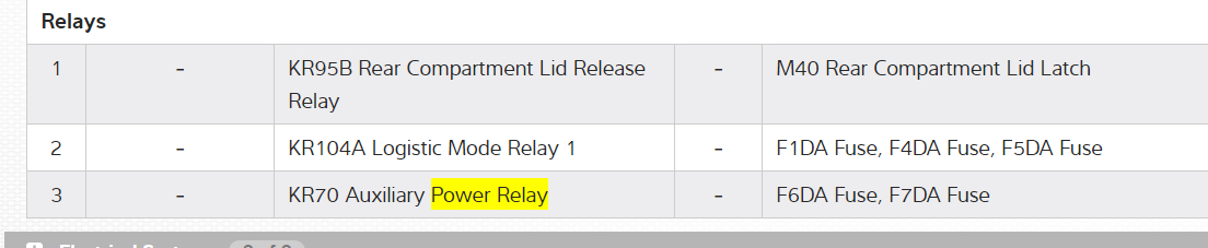

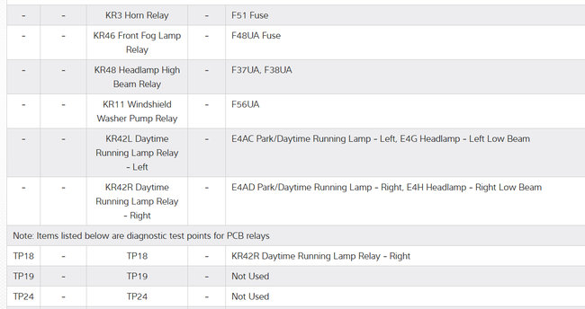

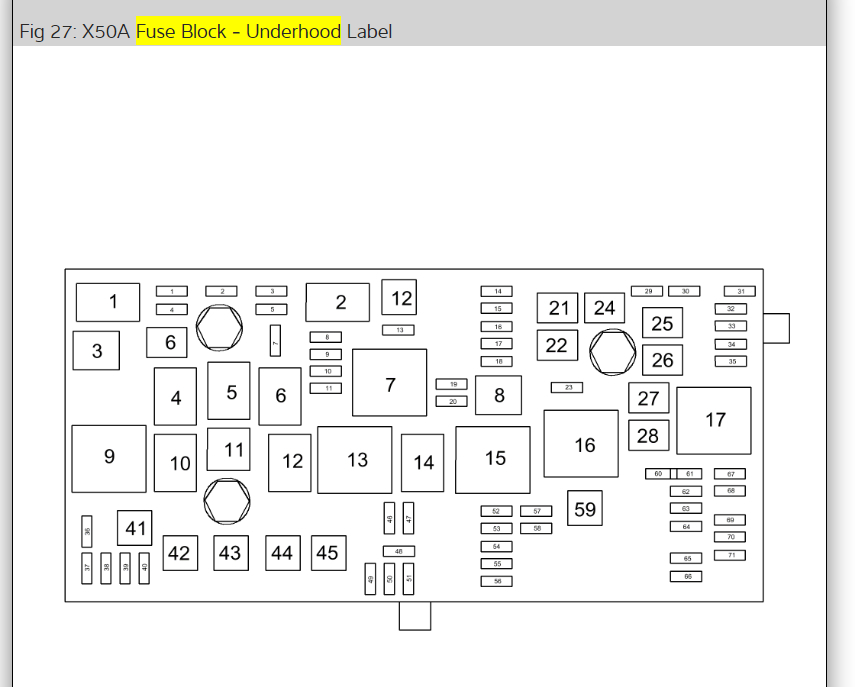

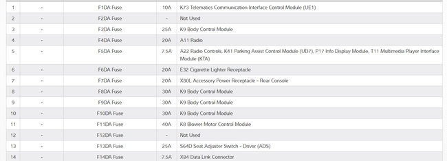

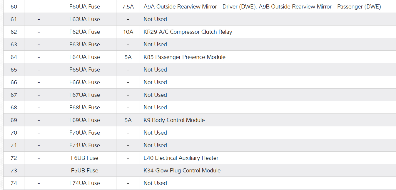

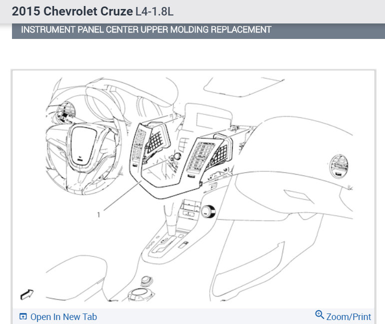

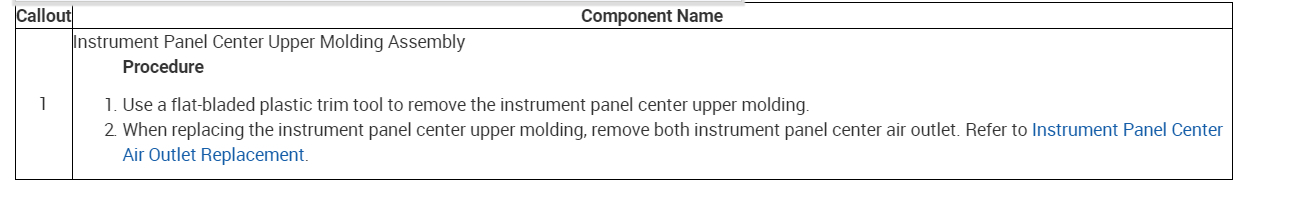

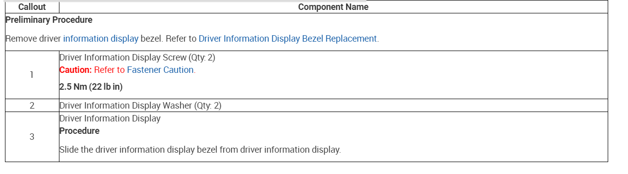

Okay, it sounds like the drivers information module has gone out here are instructions and diagrams to show you how to replace it. Also it should self initialize. Check out the diagrams (below). Please let us know what happens.
