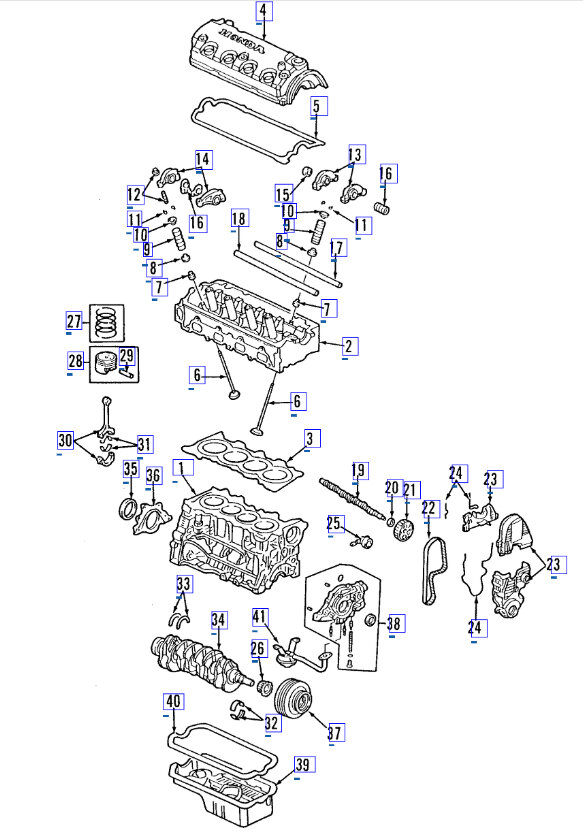

I am leaking oil out of the part right above the oil pressure switch. I need a diagram to tell me what the parts are where I can buy new ones.

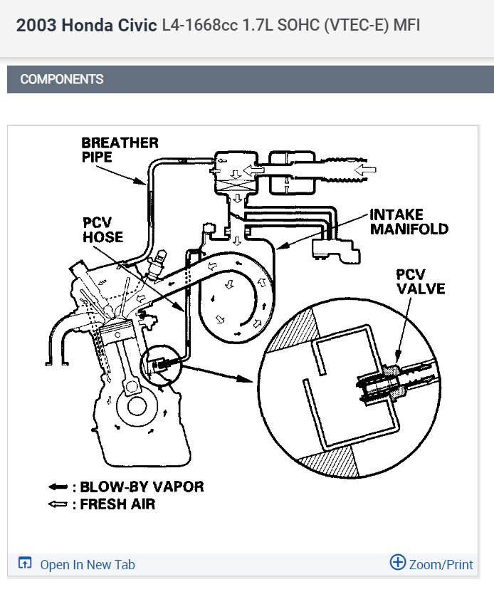

I think the PCV valve housing/gasket is leaking which I have seen before here is the location so you can check it out. Check out the images (below). Please upload pictures or videos in your response of any problems so we can see what to help you with.
