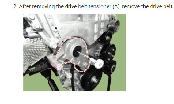

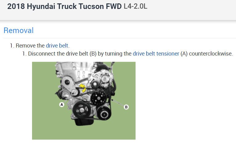

Sure, here are the serpentine belt replacement instructions with the belt routing as requested. Check out the images (below). Let us know if you need anything else.
