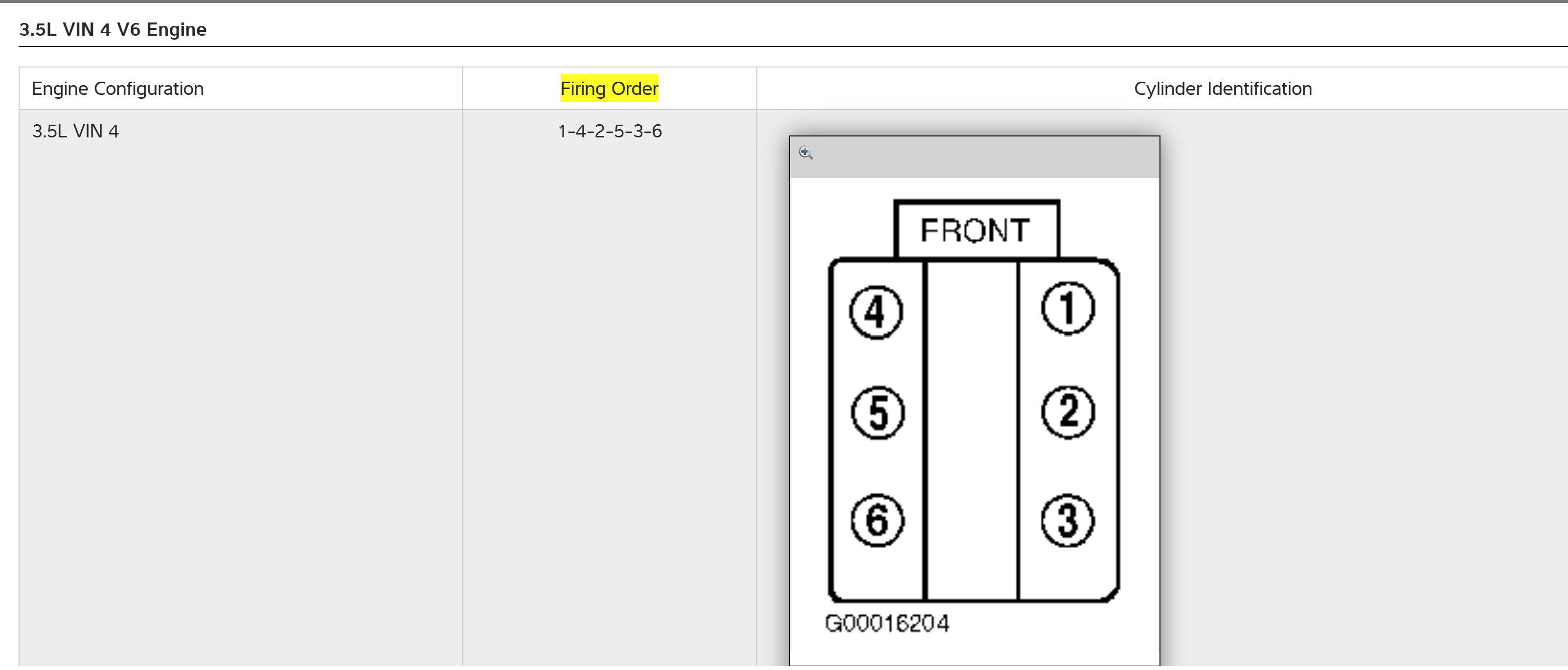

What's the spark plug diagram for this 3.5 engine?

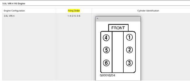

I have added an image for you for firing order and cylinder identification. Please let me know if you need anything else.
