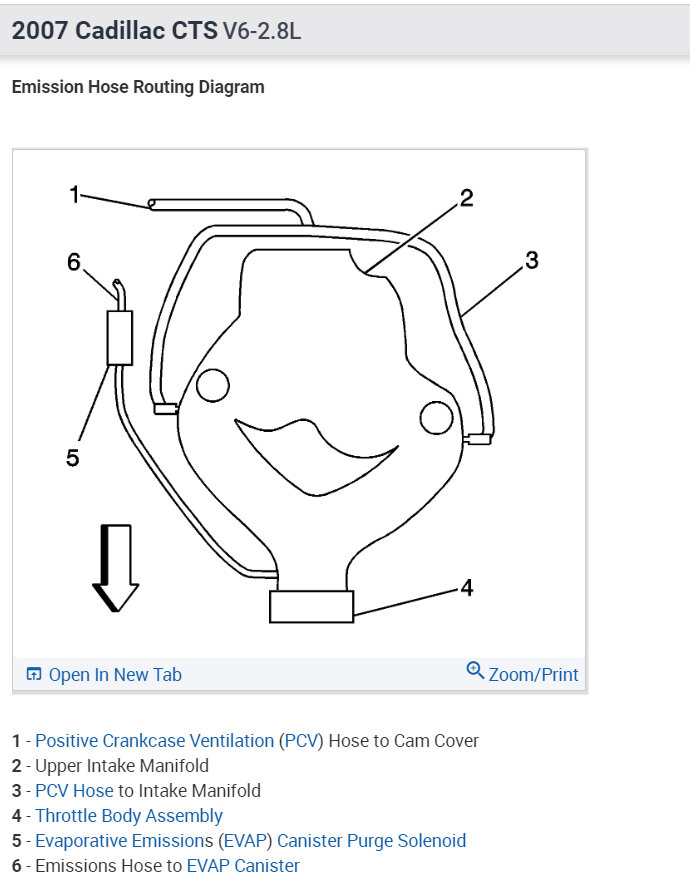

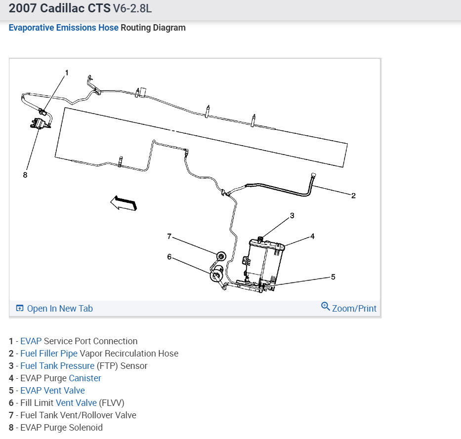

Okay, so, I figured out what I need help with I'm needing a diagram that shows me all of my vacuum hose routings and also one showing how intake goes.

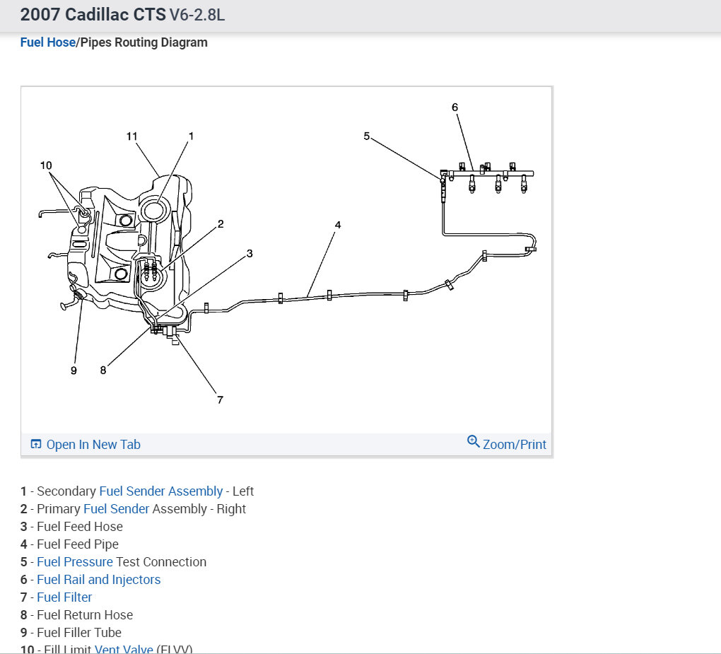

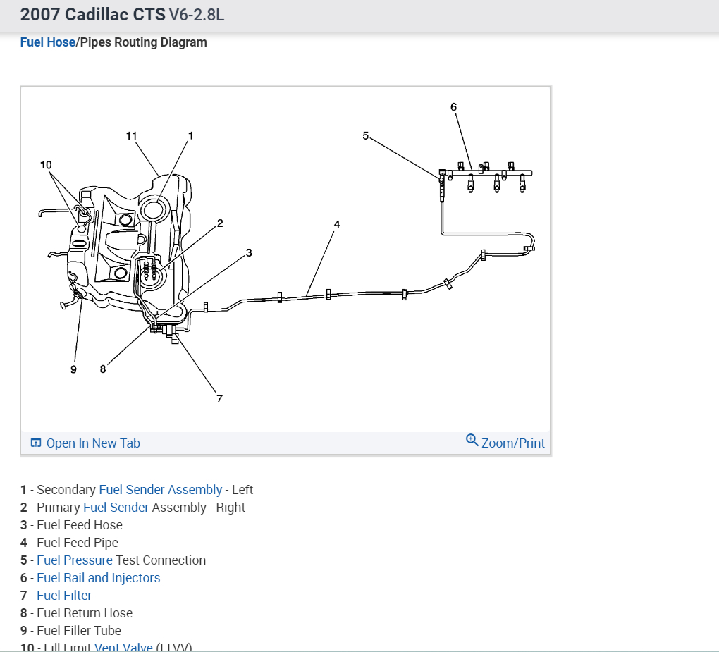

Sure, here are all vacuum and emissions vacuum line routing diagrams. Check out the images (below). Let us know what happens and please upload pictures or videos of the problem so we can see what's going on.
