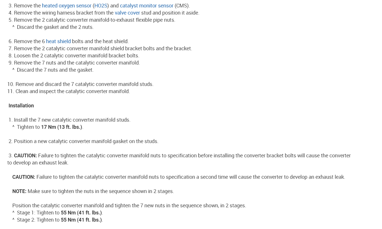

Hello, I need help with a diagram to remove and replace a exhaust manifold converter on my vehicle listed above.
May 30, 2023 at 9:41 PM

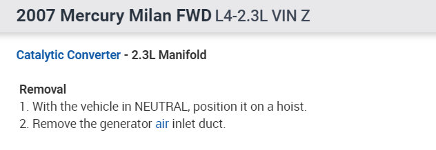

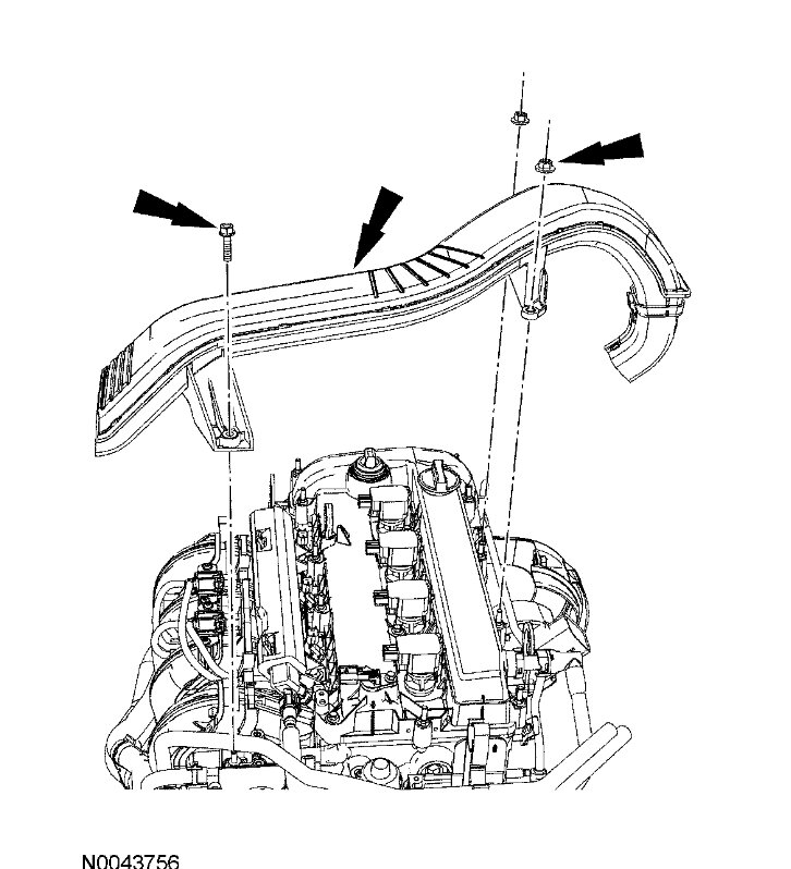

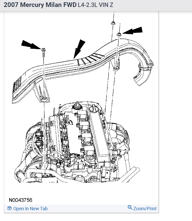

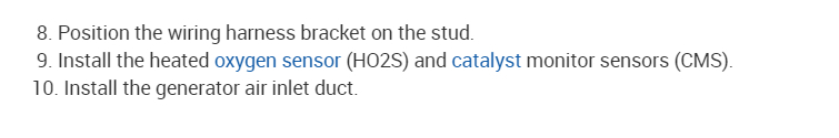

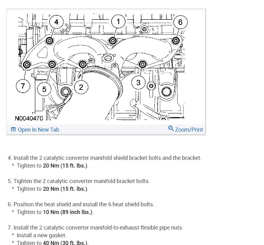

Sure, here are the instructions on how to change out the exhaust manifold and catalytic converter. Check out the images (below). Please let us know if you need anything else to get the problem fixed.
