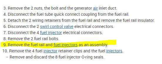

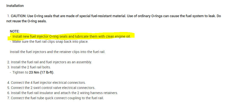

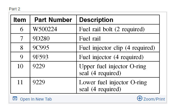

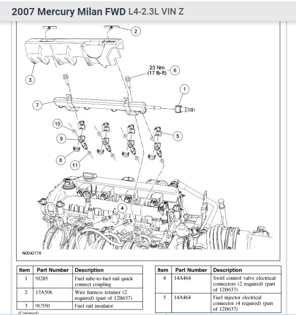

When you do this, the fuel rail and injectors are removed together. Also, when you install the new injector o-rings, make certain to lubricate them with motor oil or even Vaseline.

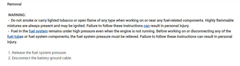

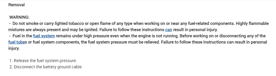

If you look below, I attached the directions for the removal. Make sure the battery is disconnected prior to starting and the fuel pressure is released. The best thing with pressure is to remove the fuel pump fuse and run the engine until it runs out of fuel.

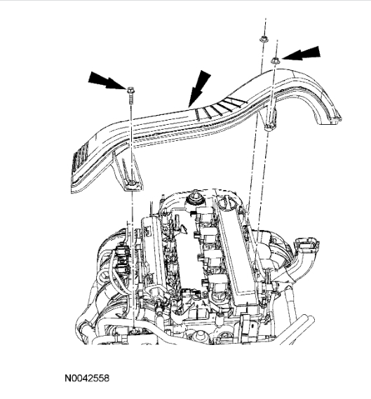

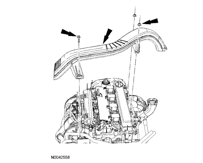

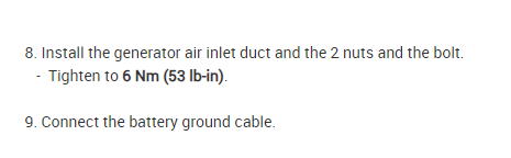

See pics below.
