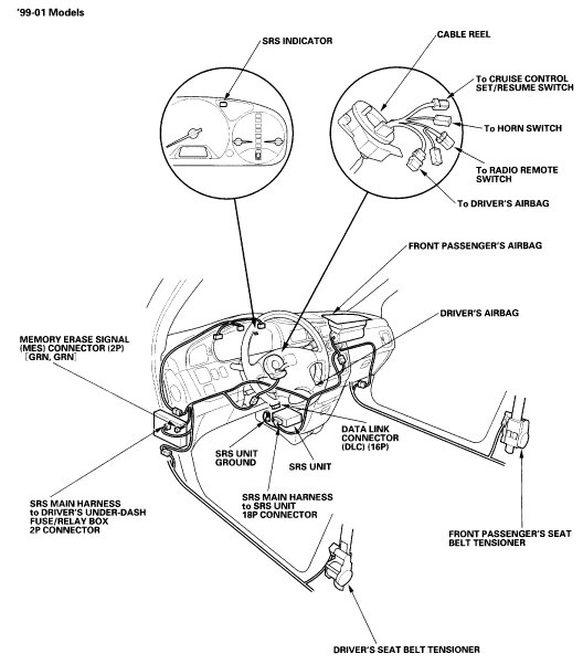

I am trying to locate the diagnostic female plug fitted to my vehicle.
The diagnostic computer tells me it is located under the dashboard down by the bonnet release catch.
It is not.
Can it be located elsewhere on the vehicle?
May 23, 2018 at 11:12 AM
Hi and thanks for using 2carpros.com. I have attached a picture of its location. I hope it helps. Check out the diagrams (Below). Please let us know if you need anything else to get the problem fixed.
