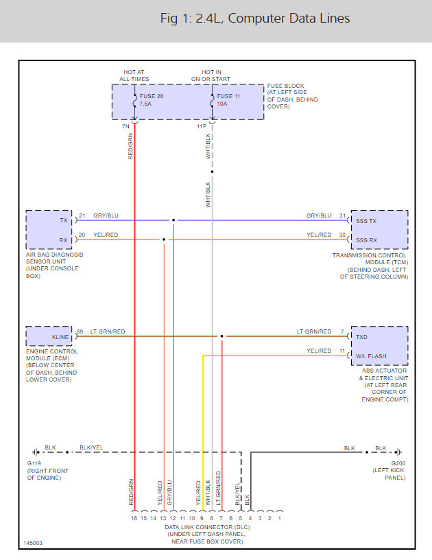

ELM327 not communicating with ECU.
Jun 18, 2018 at 2:09 AM
The first thing I would do is plug the scanner into a different car to make sure it works. Then check the fuses #26 and #11 which power the ALDL. Here is a guide to help you run a test and the wiring diagrams so you can see how it works:
