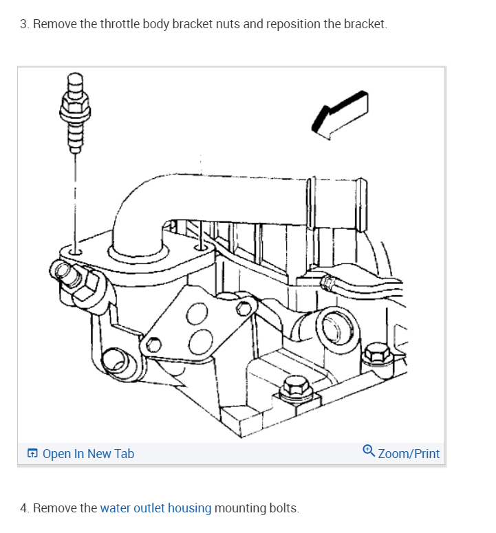

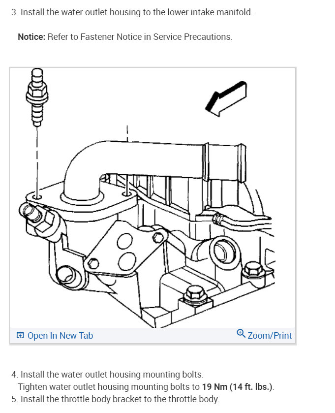

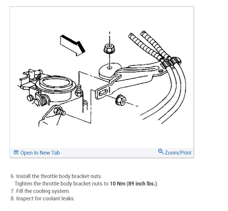

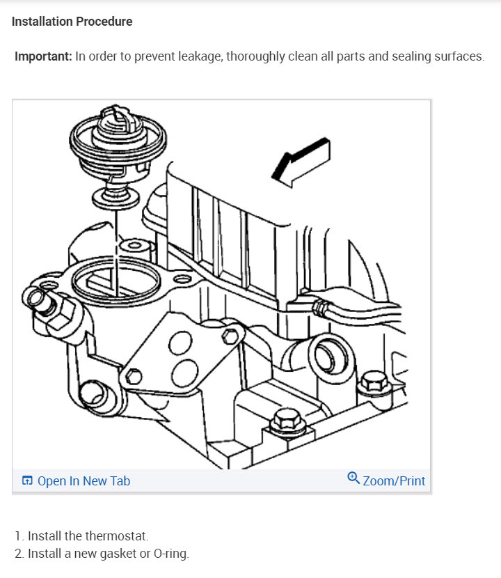

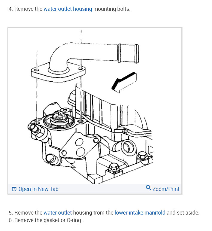

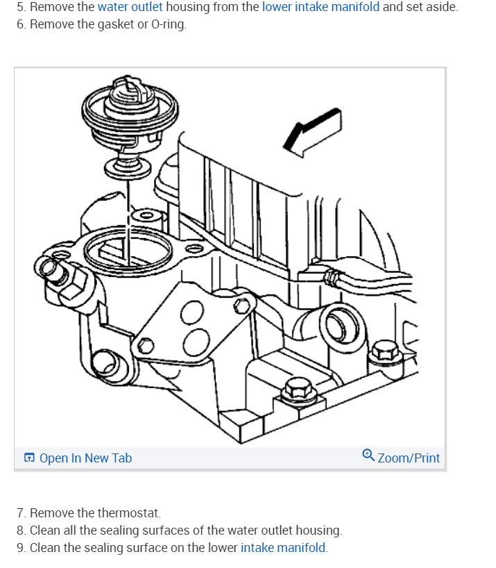

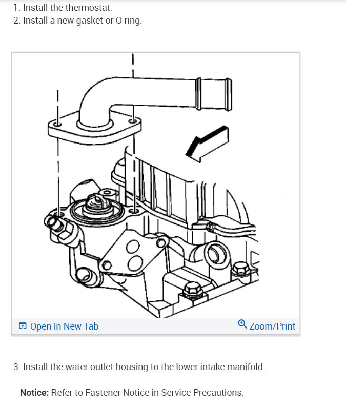

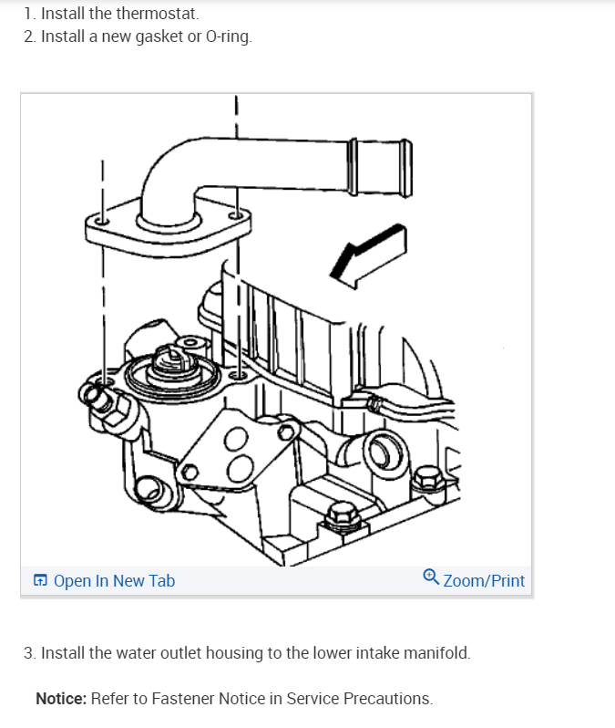

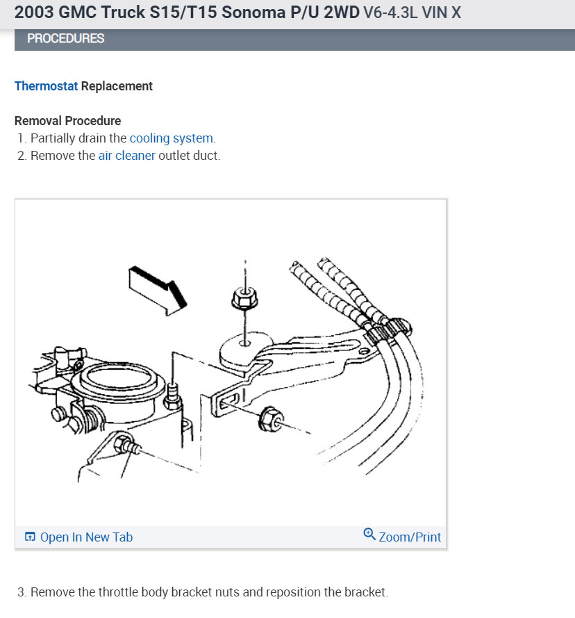

This sounds like you have a broken thermostat which allows the engine to warm up too slow, this will not allow the computer to go into "closed loop" within a specific amount of time. This is why there are no codes because the computer is not set up for this kind of failure. There is a guide to walk you through the replacement and inspection with instructions below to show you how on your car.

I'll be replacing the thermostat today and will let you know if it resolved the problem. Thanks for the information, I would have never thought about this as a possible cause.

Yes, the computer needs to go through its cycle. please let me know what the thermostat looks like, it should be obvious.
