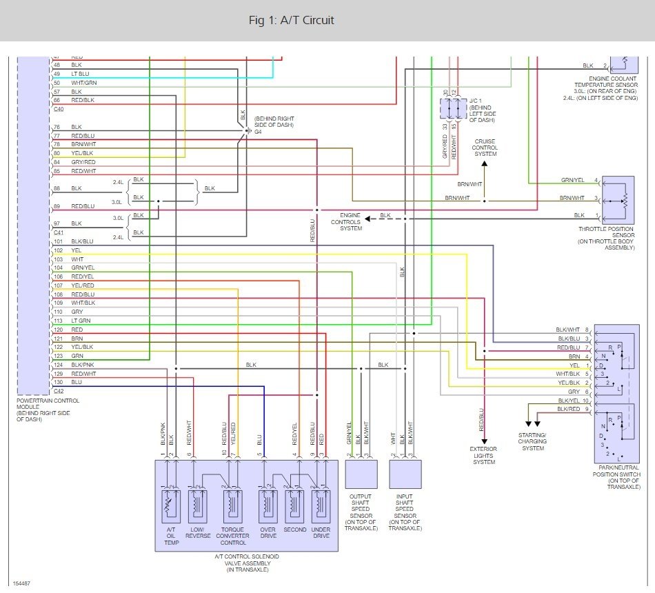

Was on the freeway going sixty miles per hour all the sudden my car dropped down to forty miles an hour and would not accelerate a couple days. before that my anti-lock light kept coming on when I pulled my car over and parked and tried to drive it again it would not move it just revved up real high no matter what gear I put it in it would not move. someone said solenoid, my transmission fluid was full.
Jun 18, 2017 at 7:24 PM
Yep those are transmission solenoid codes. It could be from a bad solenoid or the transgression is having a problem internally.

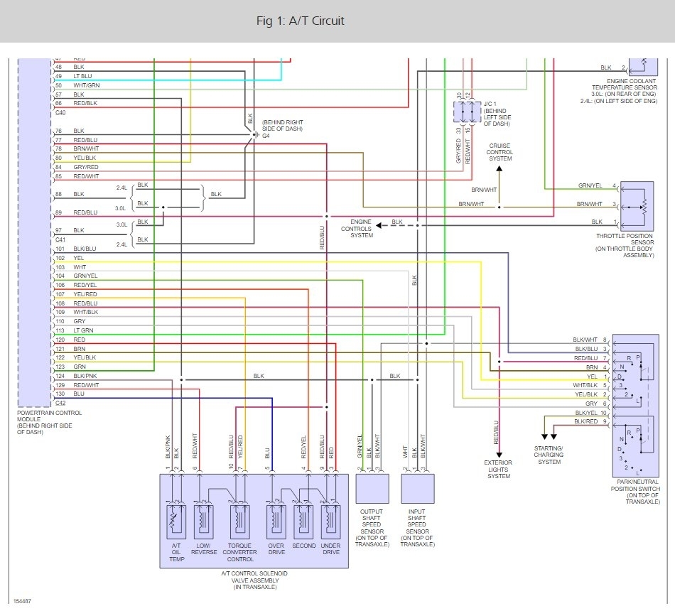

Here is a wiring diagram (below) of the solenoids so you can do some testing to confirm the failure.

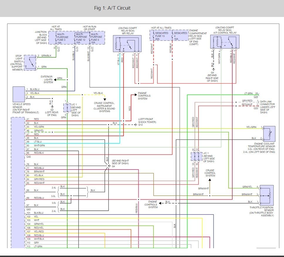

There is also some fuses and an A/T relay that may have gone bad as well.
and
Please run some tests and get back to us so we can continue helping you.
