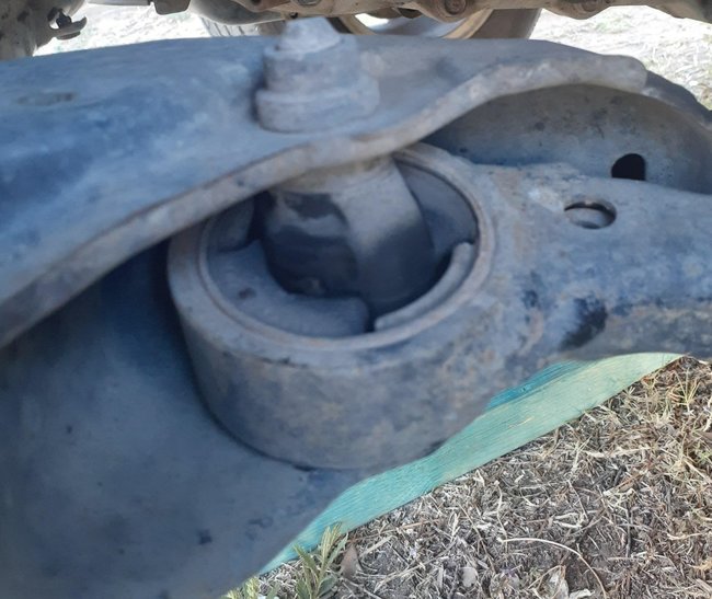

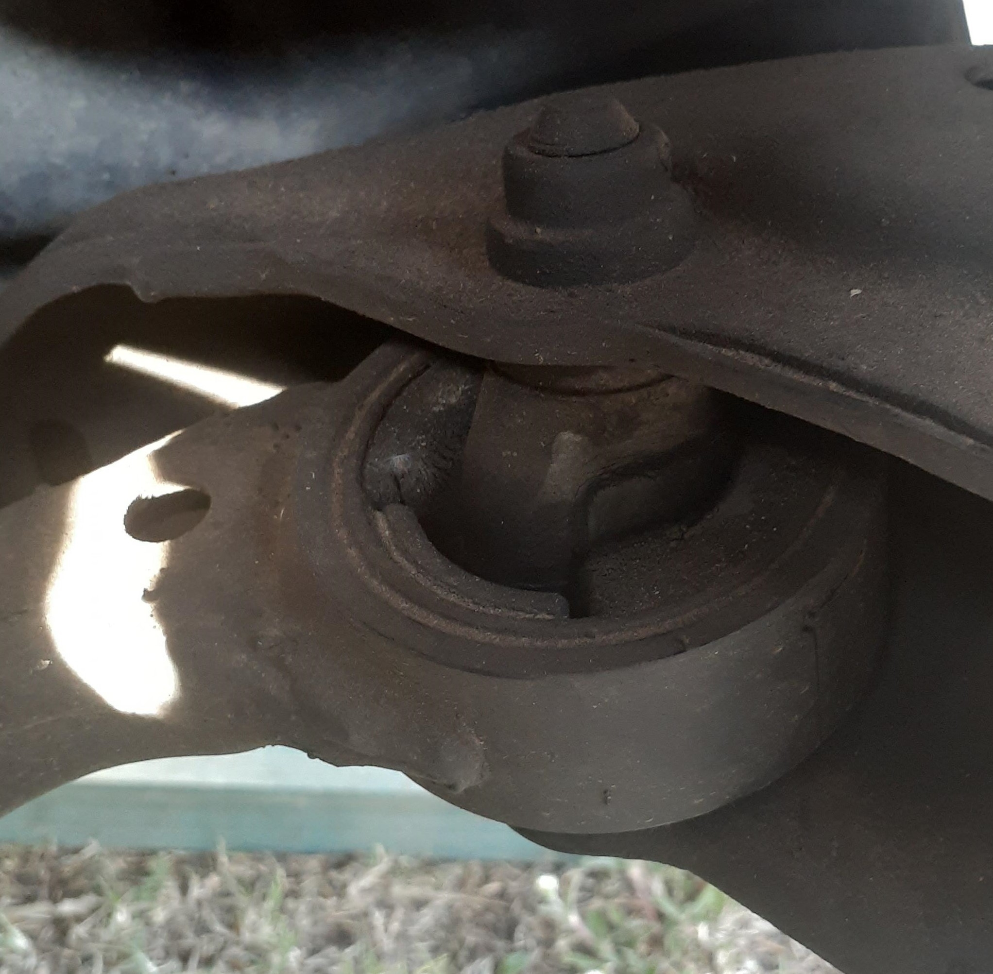

I think the bushes on both of my Front Lower Control Arm's might be the reason my front end knocks loudly when i go over a bump, what do you think? Anybody know where i can buy cheapest "Front (L+R) Lower Control Arm with Bushes + Ball Joint already installed? I am after the complete part that's ready to install without stuffing around so i can do the install myself. (picture is with car jacked up off the ground)

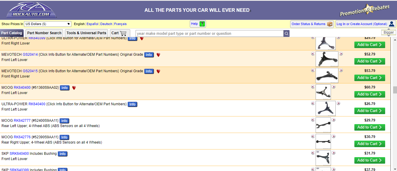

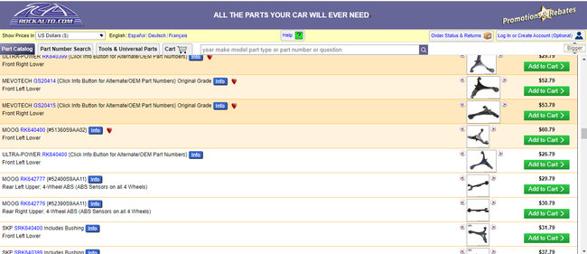

Okay, I found the parts at rock auto.
I attached the list of arms and prices. This would be the easiest and cheapest for you.
