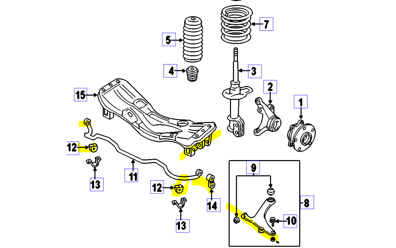

I attached a couple pics below. The first is the front suspension. Make sure there is no play in the control arm bushings and control arm bushings (see highlighted parts in pic 1)

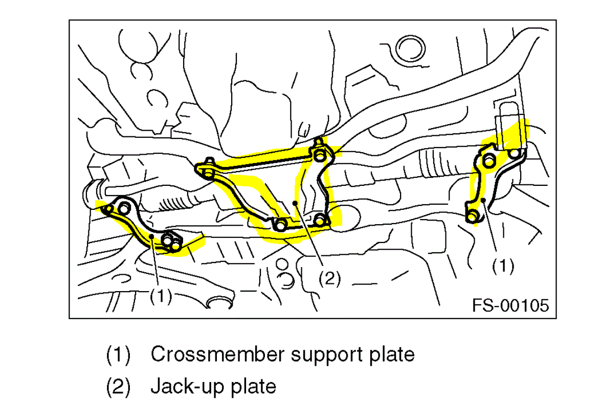

Next, make sure the front cross member support plates are tight. (highlighted in pic 2).

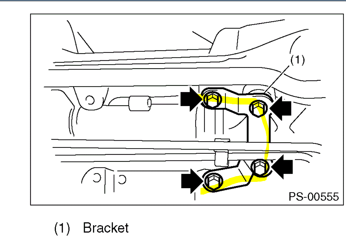

Third, check the rack and pinion gear support bracket bolts to make sure they are tight. (highlighted in pic 3)
