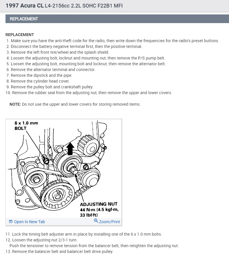

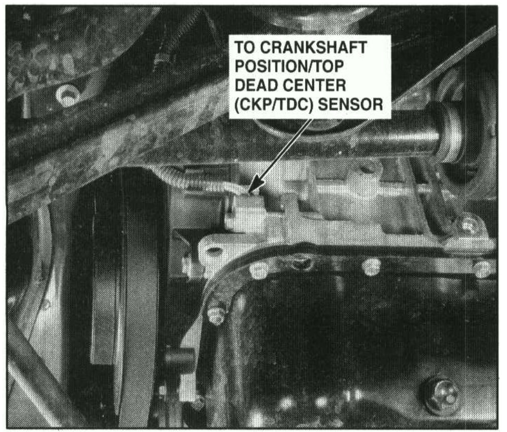

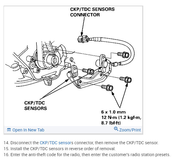

On this vehicle the crank sensor or the TDC sensor is located at the Lower Left Rear of Engine (see image below).
In order to replace the sensor, you will have to remove several components including the timing cover and the crank pulley.
Let me know of any questions.
Thank you.
