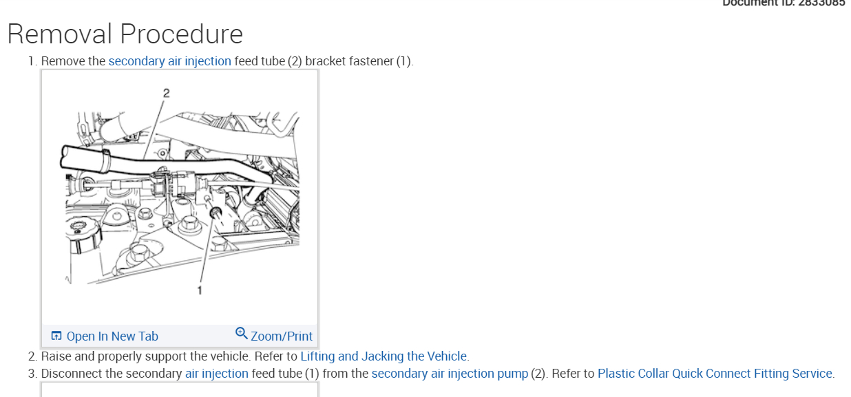

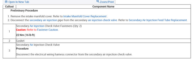

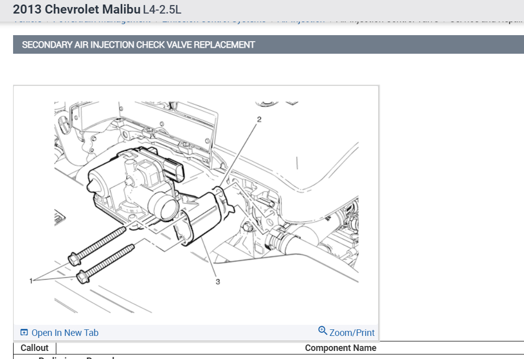

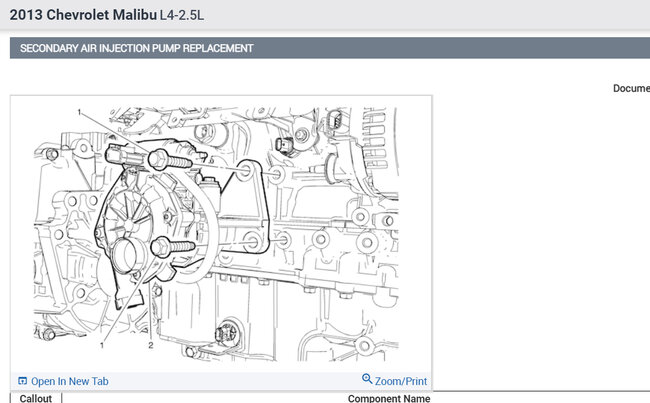

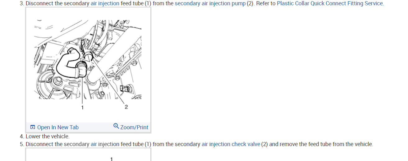

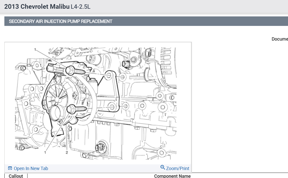

Also here are the components so you can see how the system works and if you tell me which code you have, I can help you fix it.
