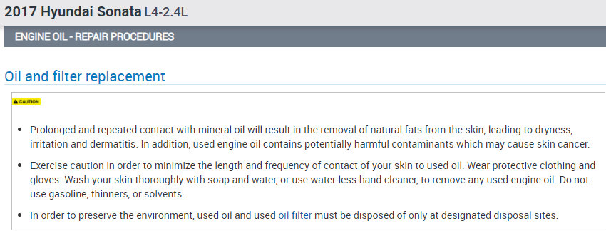

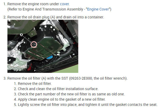

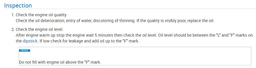

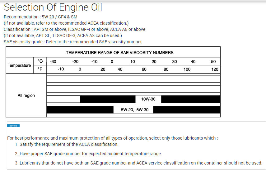

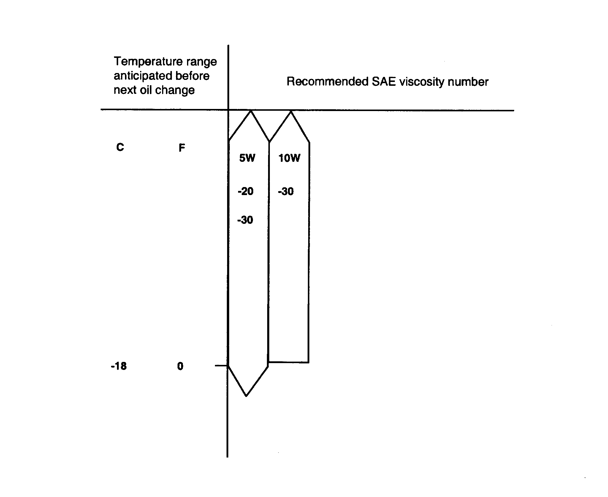

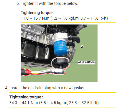

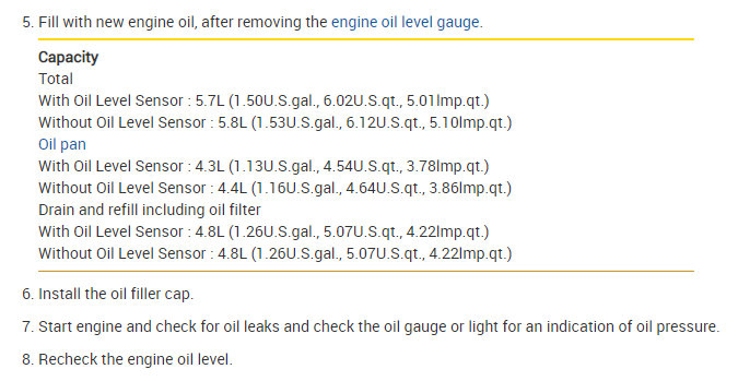

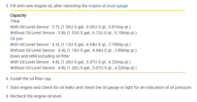

I've attached picture steps below on how to change the engine oil and oil filter on your vehicle. Hope this helps and thanks for using 2CarPros.

HADDIX61
Need to change the engine oil and filter can you help me please?
Feb 24, 2021 at 11:49 AM (Merged)
Changing engine oil and filter isn't hard to do. It should be done based on the manufacturer's recommended maintenance schedule.
First, here is a link that explains in general how it's done. You can use this as a guide when doing it.
https://www.2carpros.com/articles/how-to-change-engine-oil-and-filter
Here are directions specific to your vehicle. The attached pic correlate with the directions.
