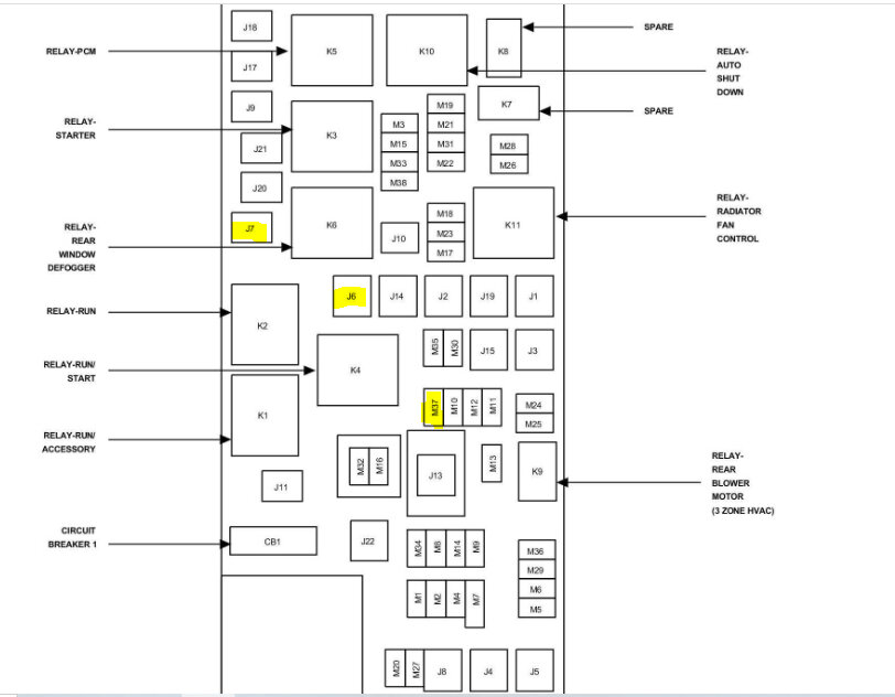

The U codes indicated are both related to wheel distance and speed. That is why the transmission is having trouble shifting. Also, one of the most common causes for these codes is a loss of power to the ABS module, which could explain why the light is on. The P0507 indicated a high idle which is likely caused by an engine vacuum leak. On these vehicles, it isn't uncommon for the PCV to fail. Here is a link to help locate a leak.

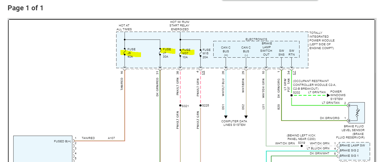

So, the easiest thing is to check if the ABS module is getting power. If you look below, I attached a pic and highlighted three fuses. These are power supplies to the ABS module. I need you to check the fuses and confirm there is power to and from them. (Pic 2 shows the fuse locations in the under-hood power distribution box)
Let me know what you find.
