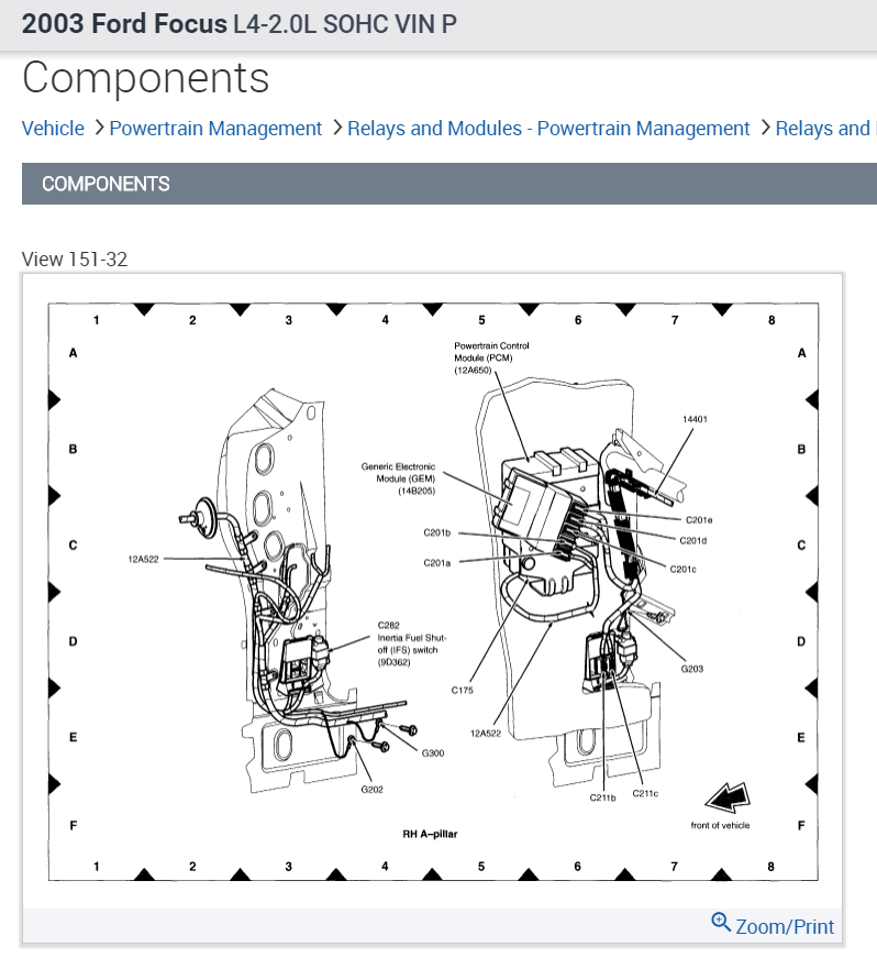

Great, I would get a used PCM and plug it in to see what happens. My thinking is the computer is slow to boot which keeps the car from starting. Here is the PCM location.
Check out the diagrams (Below). Please let us know what happens.
