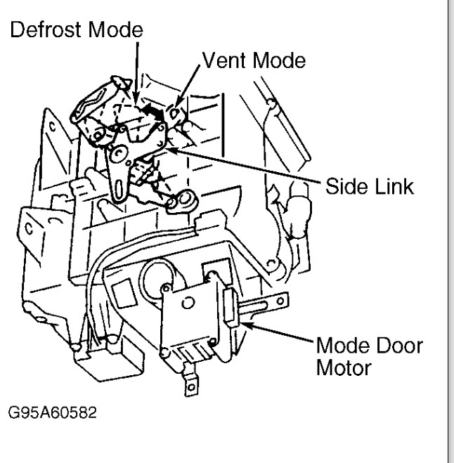

where is the defroster relay located on my car?

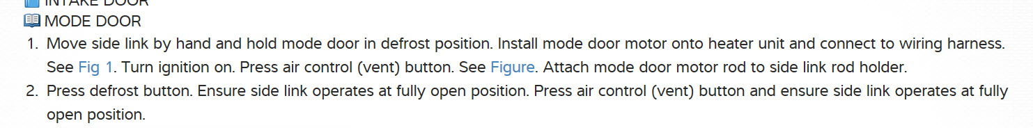

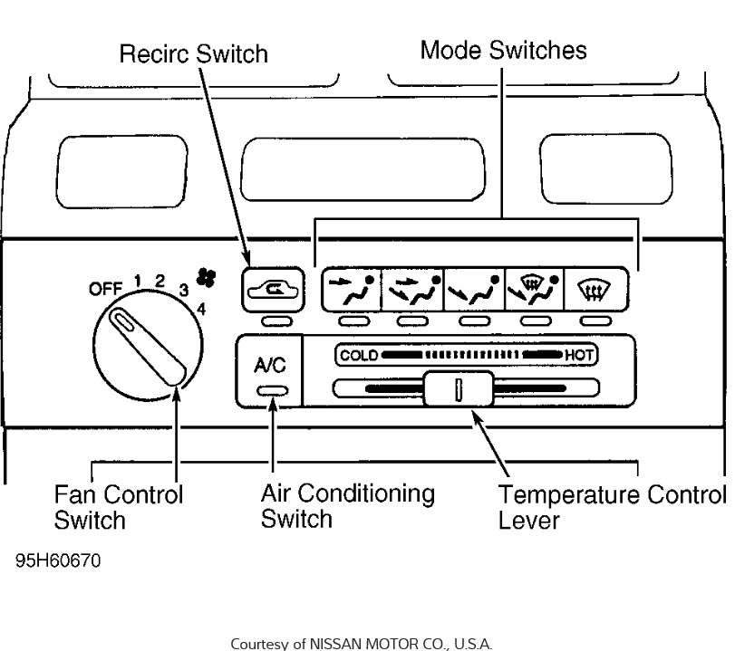

there is no relay it is a mode door and motor or linkage is messed up. see pictures on how to adjust or replace it.
