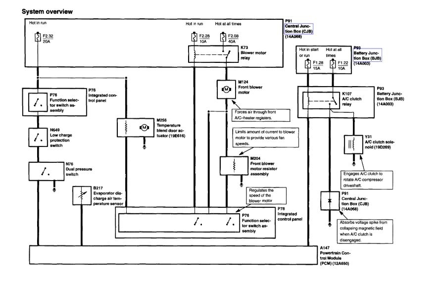

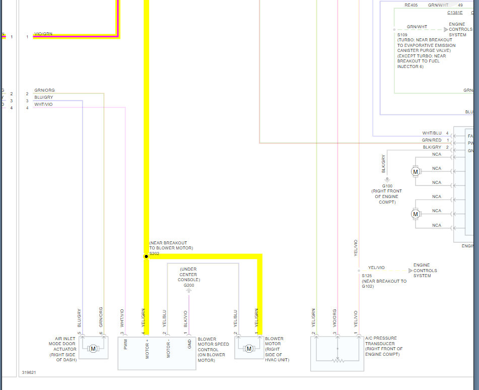

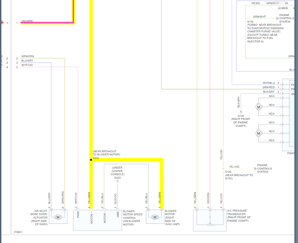

Below you will find the wiring diagram from the manual.
We need to start with checking voltage at the blower motor and then go back through the system until we find voltage.
Here is a guide that will help with this type of testing:
Please run through this diagram and let us know if you have questions on this.

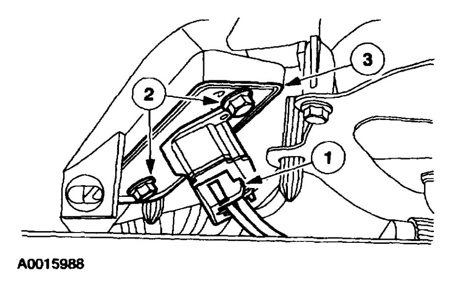

The blower is not working on the heater. It was working this morning but not now. Replace a/c compressor last October. How difficult is it to replace the blower?
Jun 22, 2021 at 11:33 AM (Merged)
DAVE H
  • 13,384 POSTS

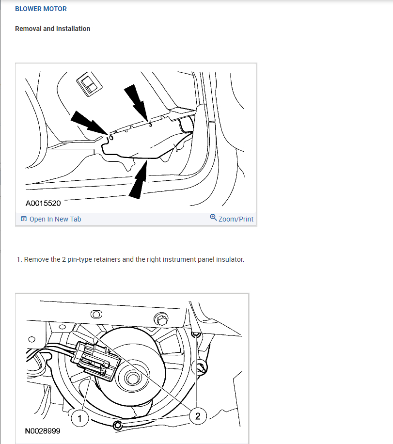

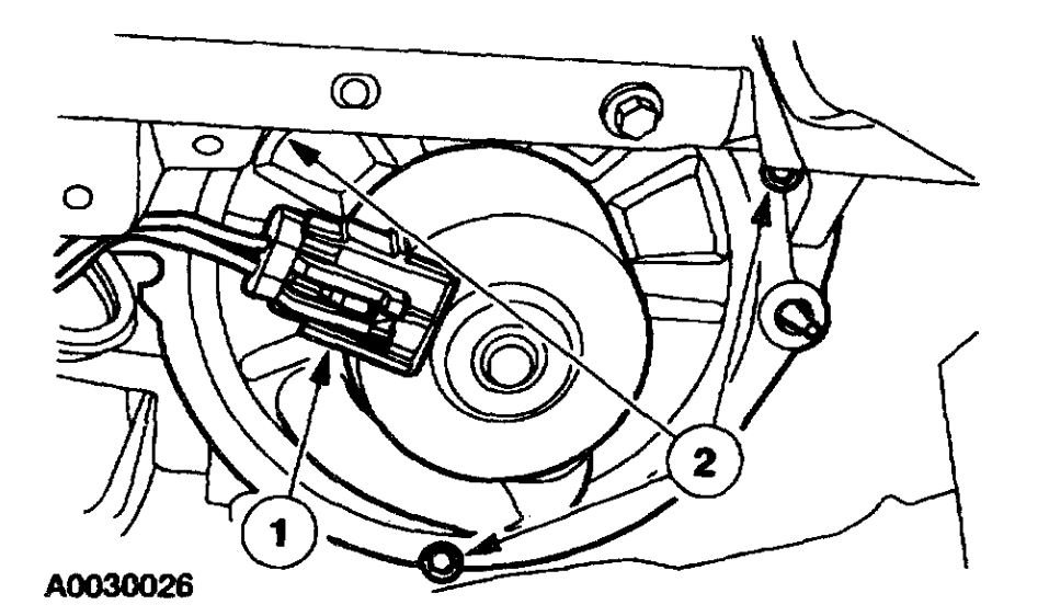

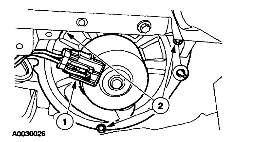

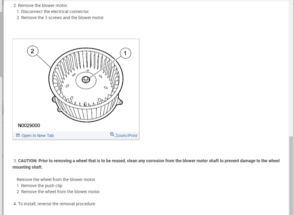

Removal and Installation Remove pin-type retainers and the right instrument panel insulator. Fig. 1: Removing Right Instrument Panel Insulator Courtesy of FORD MOTOR CO. Remove the blower motor (19805). Disconnect the electrical connector Remove the screws and remove the blower motor. Fig. 2: Removing Blower Motor Courtesy of FORD MOTOR CO. To install, reverse the removal procedure.

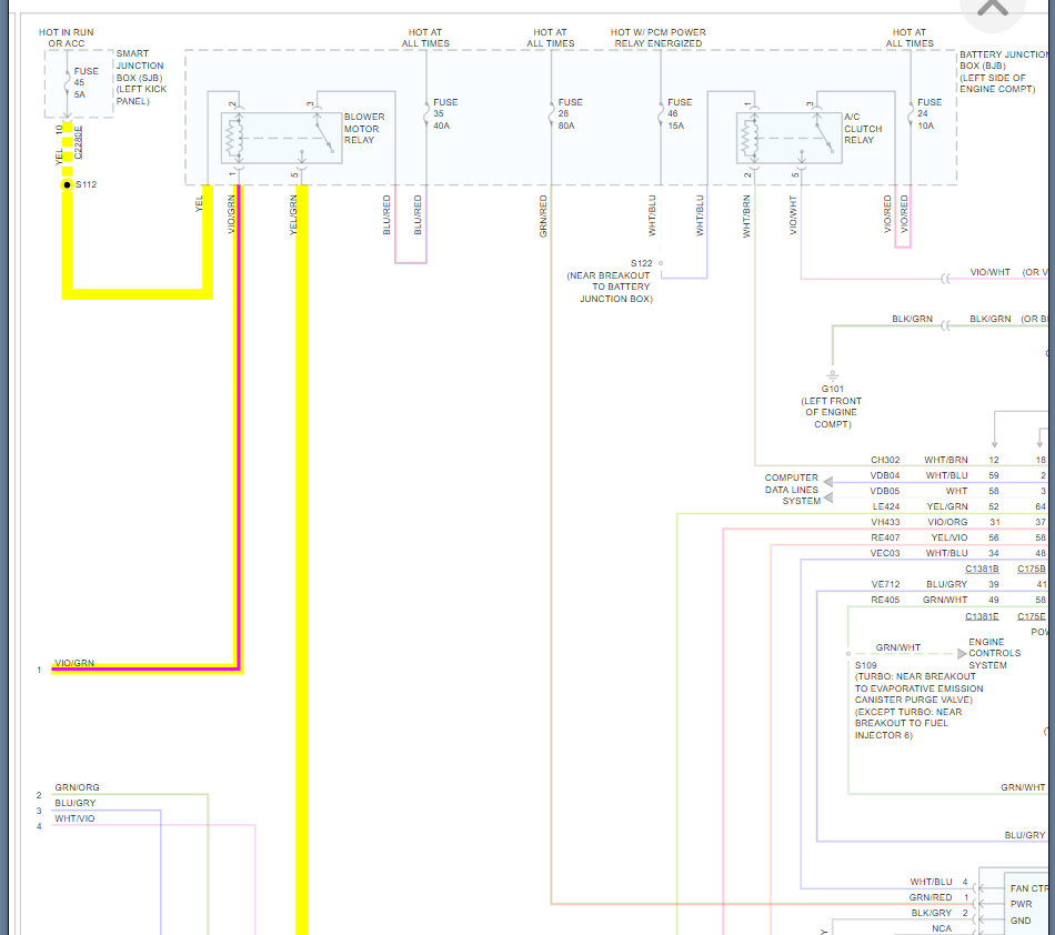

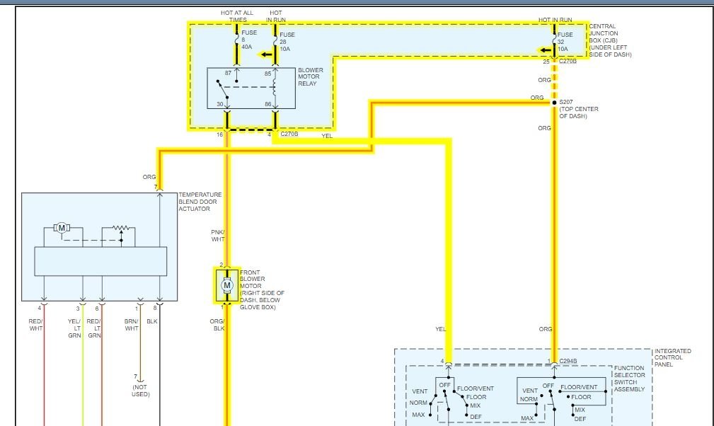

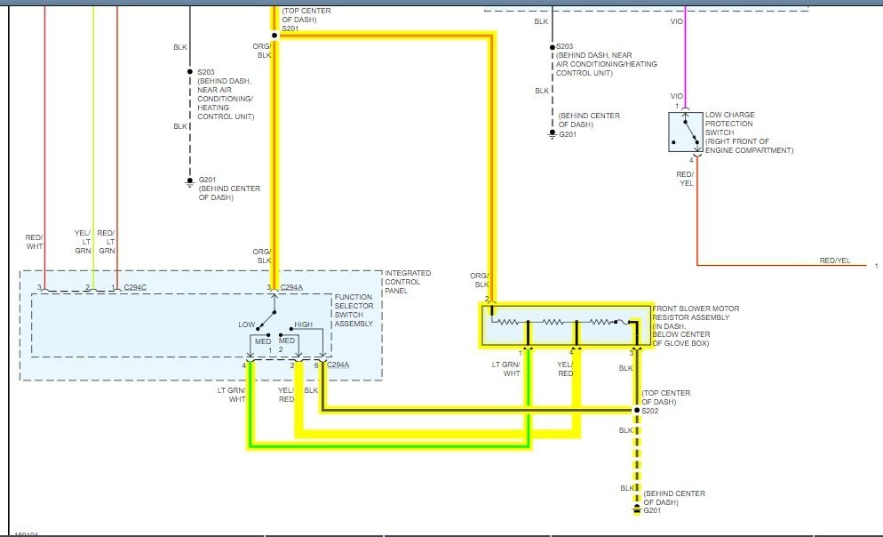

Good morning.
I attached a wire diagram for you to view. Check the fuses with a test for power on both sides. There is a relay that needs power in order to let the blower motor work.
You can also check for voltage to the blower motor as well to see if the voltage is present which may indicate a bad blower motor.
The blower motor is under the right side of the dash.

Underhood Power Distribution Box relay # 24 is for the blower motor
https://www.2carpros.com/forum/automotive_pictures/99387_Graphic1_419.jpg
BLOWER MOTOR Removal & Installation Remove instrument panel insulator from instrument panel. Unplug blower motor harness connector. With key on and or engine running place the heater fan at high check for power and ground and if you have them both suspect bad blower motor Remove blower motor screws and blower motor. To install, reverse removal procedure blower motor job about $150 or so good luck
