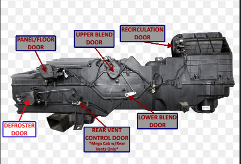

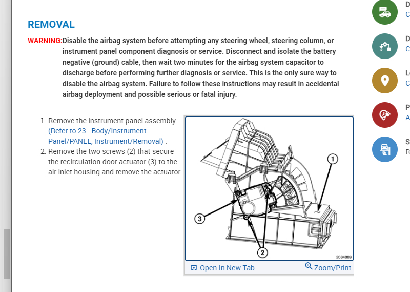

This means that I would have expected the recirc closed make a difference. So, if that makes no difference then the only thing, I can think of is that door is not fully closing except in defrost.
The way to confirm this is to use a scan tool and command the door fully closed and then see if the noise goes away.
Any chance you have a tool capable of this? I don't want to tell you to guess at the recirc door actuator but without it that is what would make the most sense.
