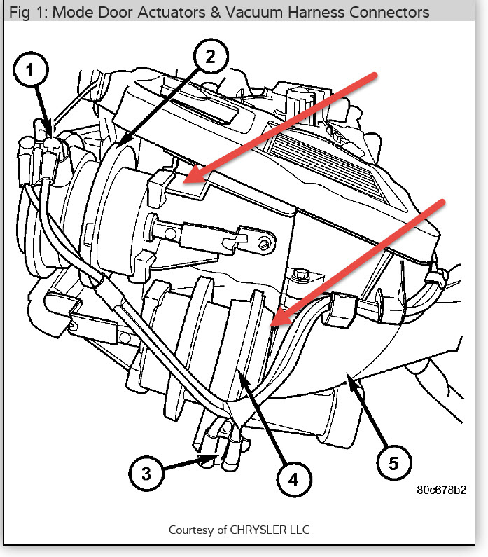

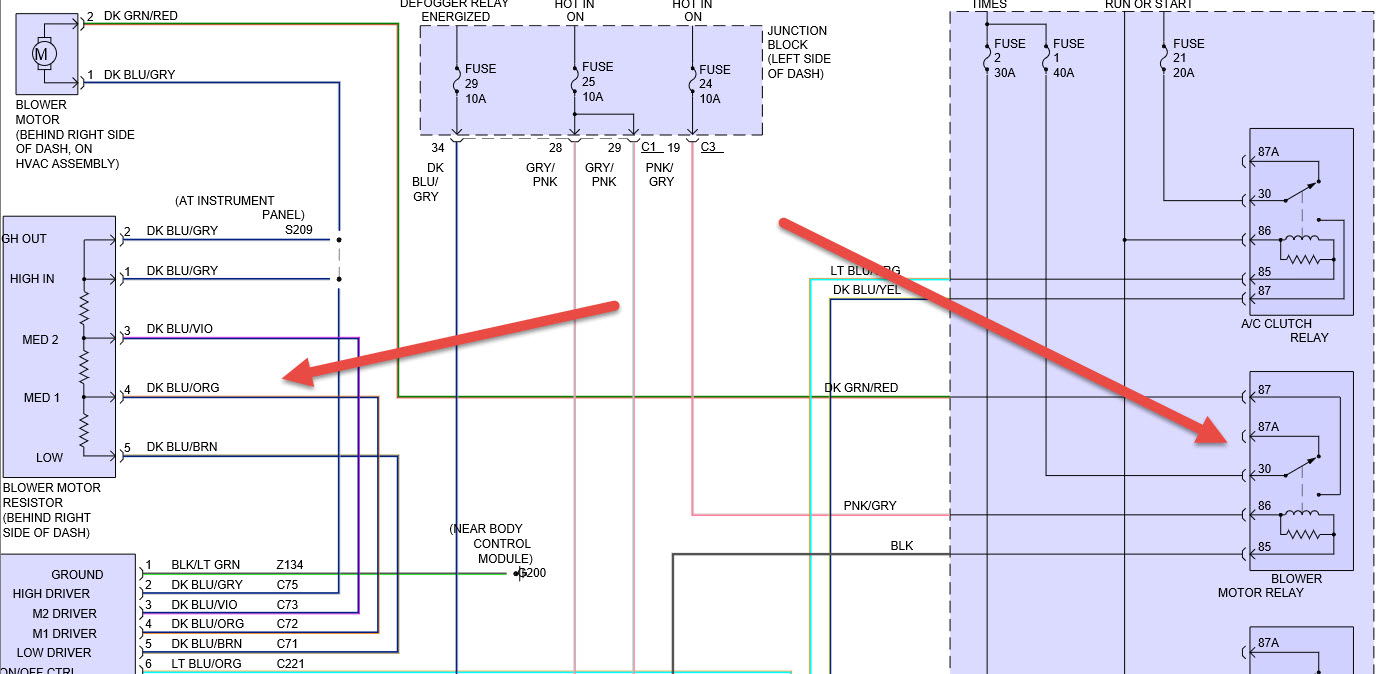

If air flow is not going/moving then check items in this picture for corrosion as well as ground on left hand front of engine compartment. If it flows everywhere except the defrosters look for a vacuum leak at motor. A vacuum leak can be anywhere between engine and mode door so check lines at control to make sure seated See pictures.
