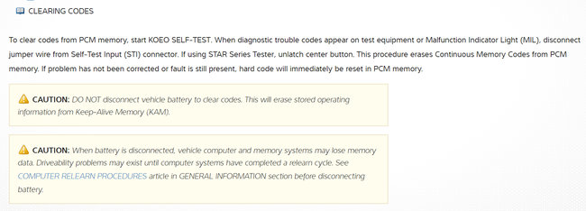

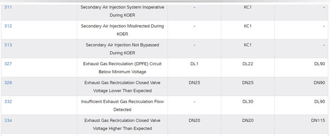

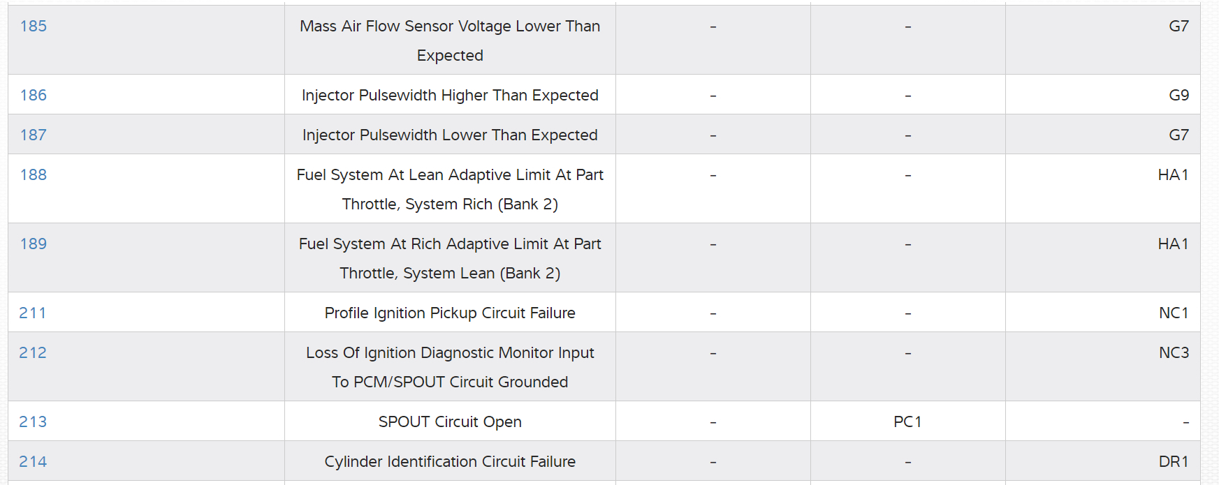

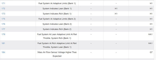

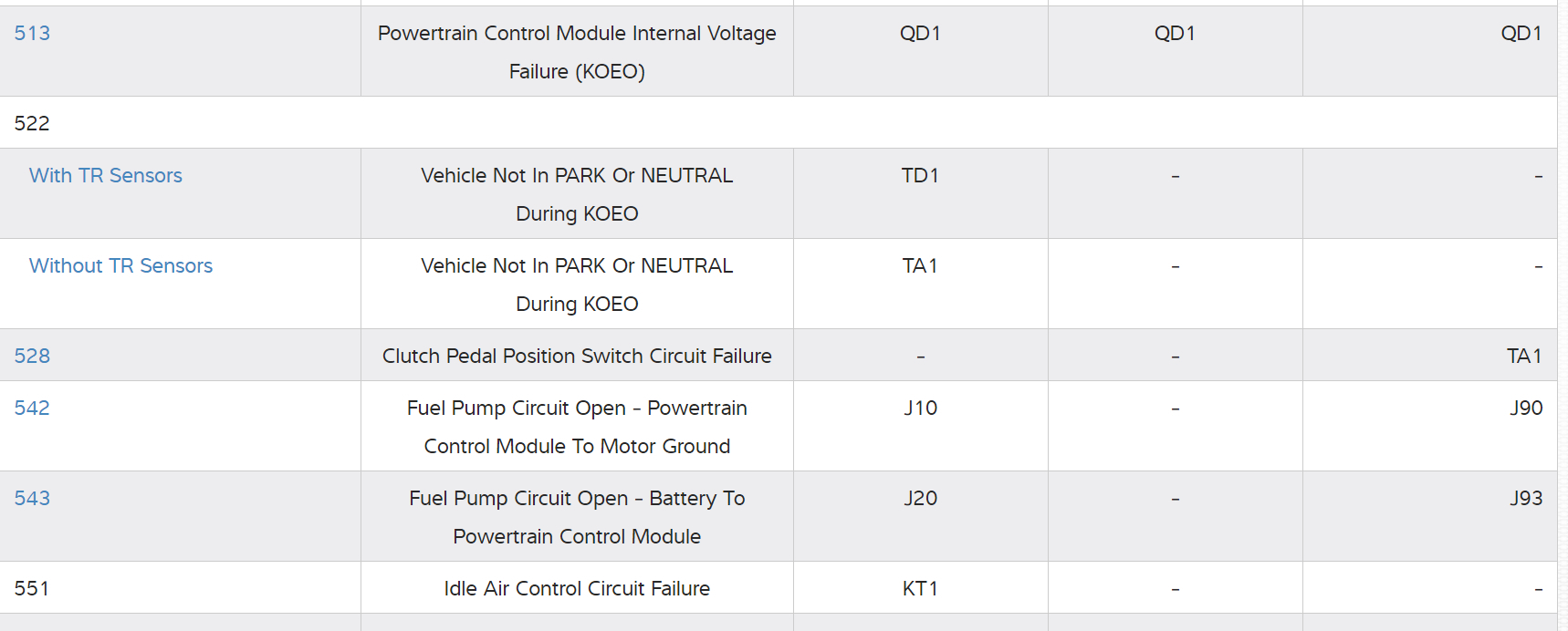

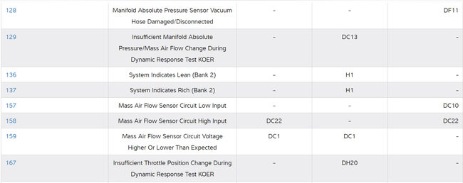

111 111 1 111 111
3 pause 3 pause 1 pause 3 pause 3 pause is the sequence.
Starts okay, after ten second starts to misfire, then runs okay once it warms up.
Please advise, is this a code 33 ? And Or 13?
Thank you for any help.
