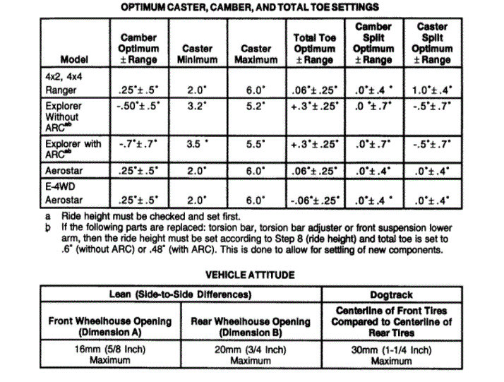

I need the spec for the front on my vehicle listed above with a 5.0.that would be on the camber, toe, and caster. Serious wobble happening.

I attached the specs for you for the alignment. Let me know if you have any other questions. Check out the diagrams (Below). Please let us know if you need anything else to get the problem fixed.
