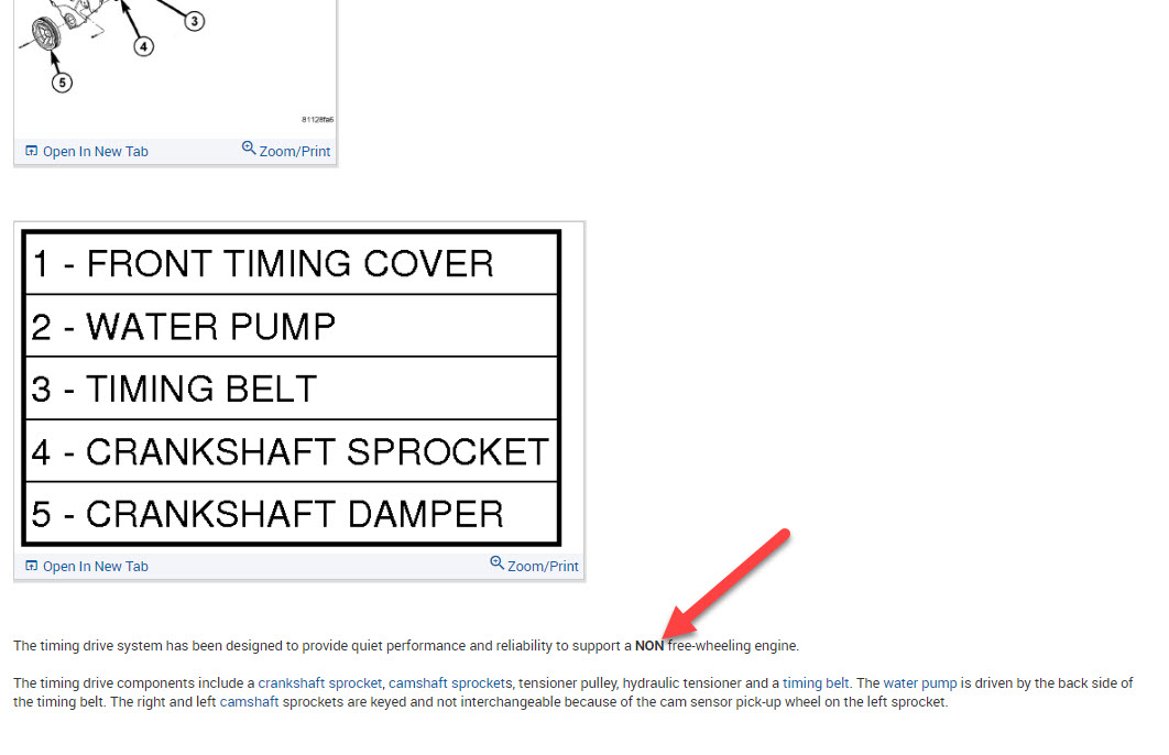

Okay, my brother in law was diving down the road and the vehicle just shut off on him and wouldn't start back. Well, checked into it and the timing belt broke plus the water pump was leaking, so changed both those. Set it back in time and started it up and now it has a dead miss to it. And when I let off the gas pedal it shuts off.
It's got a good battery in it. It's got a brand new camshaft sensor on it. So what next?
