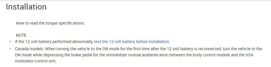

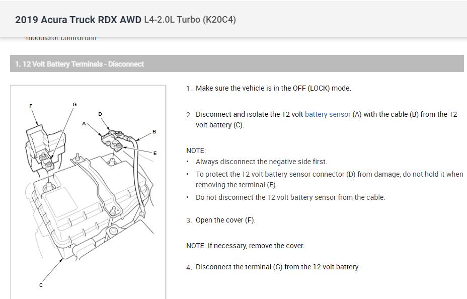

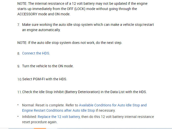

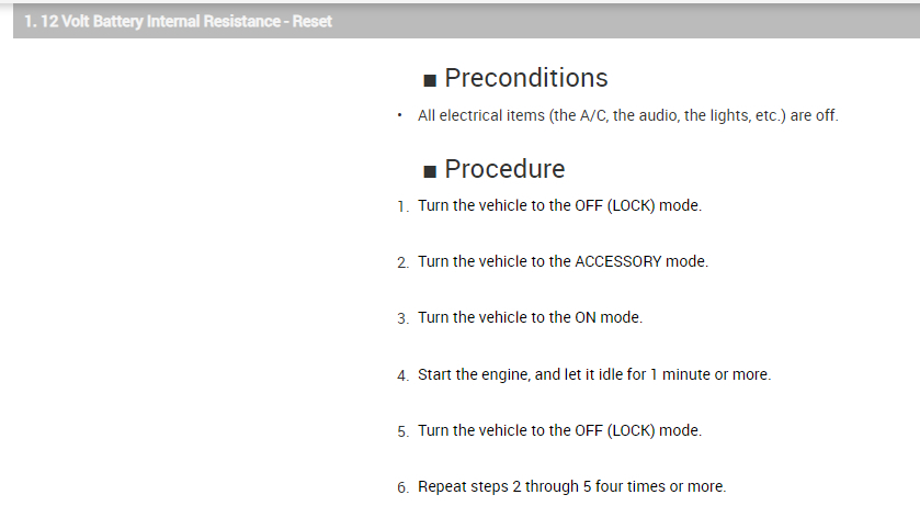

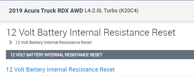

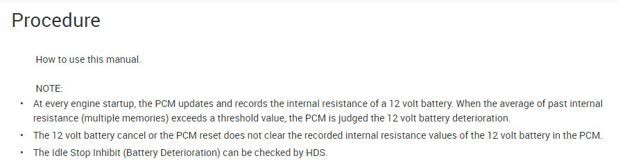

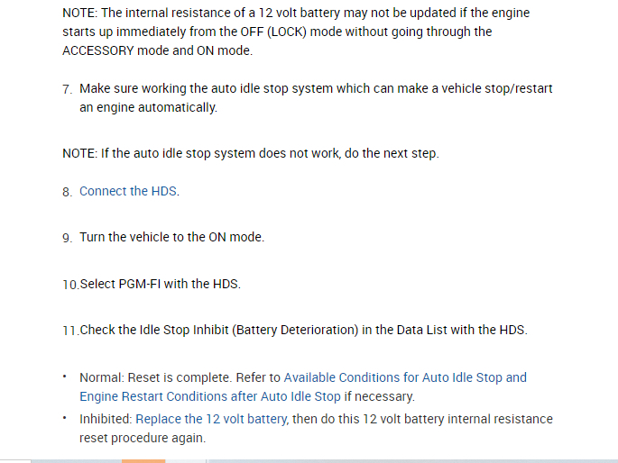

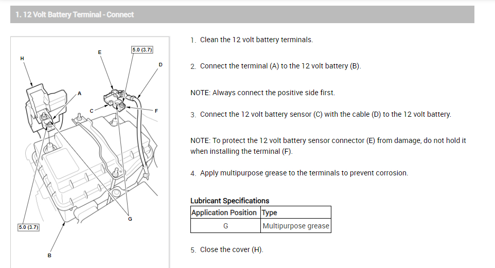

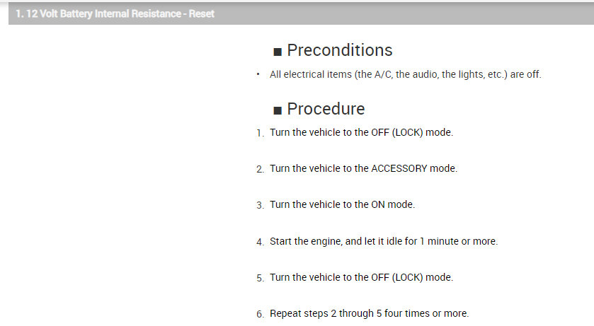

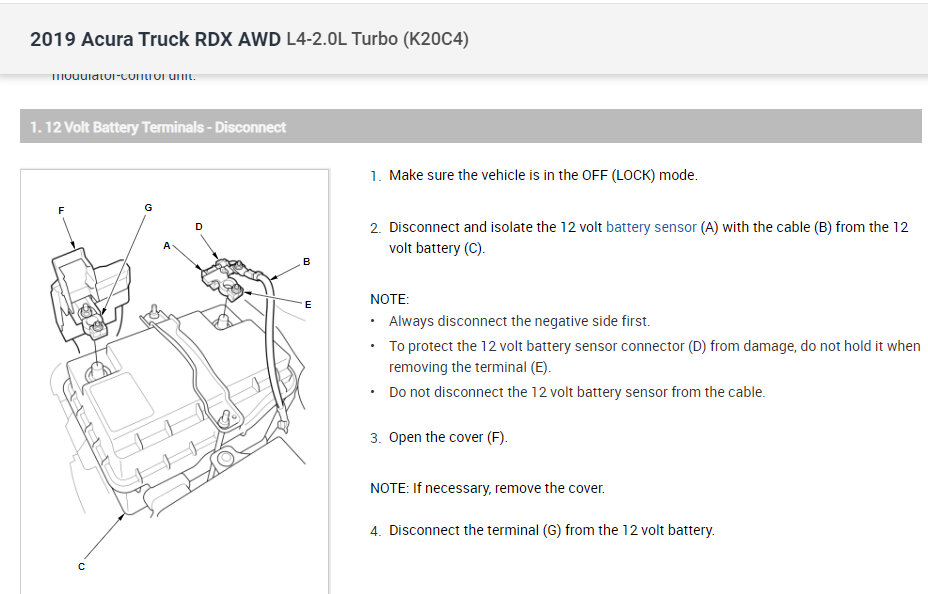

The actual replacement of the battery is straight forward. However, if you are replacing it with a new battery, there is a resistance reset that is required.
If you look below, the first three pictures are the directions specific to this vehicle for battery removal and replacement. Starting with picture 4 are the reset procedures.
Take a look through them and let me know if you have questions.
See pics below.
