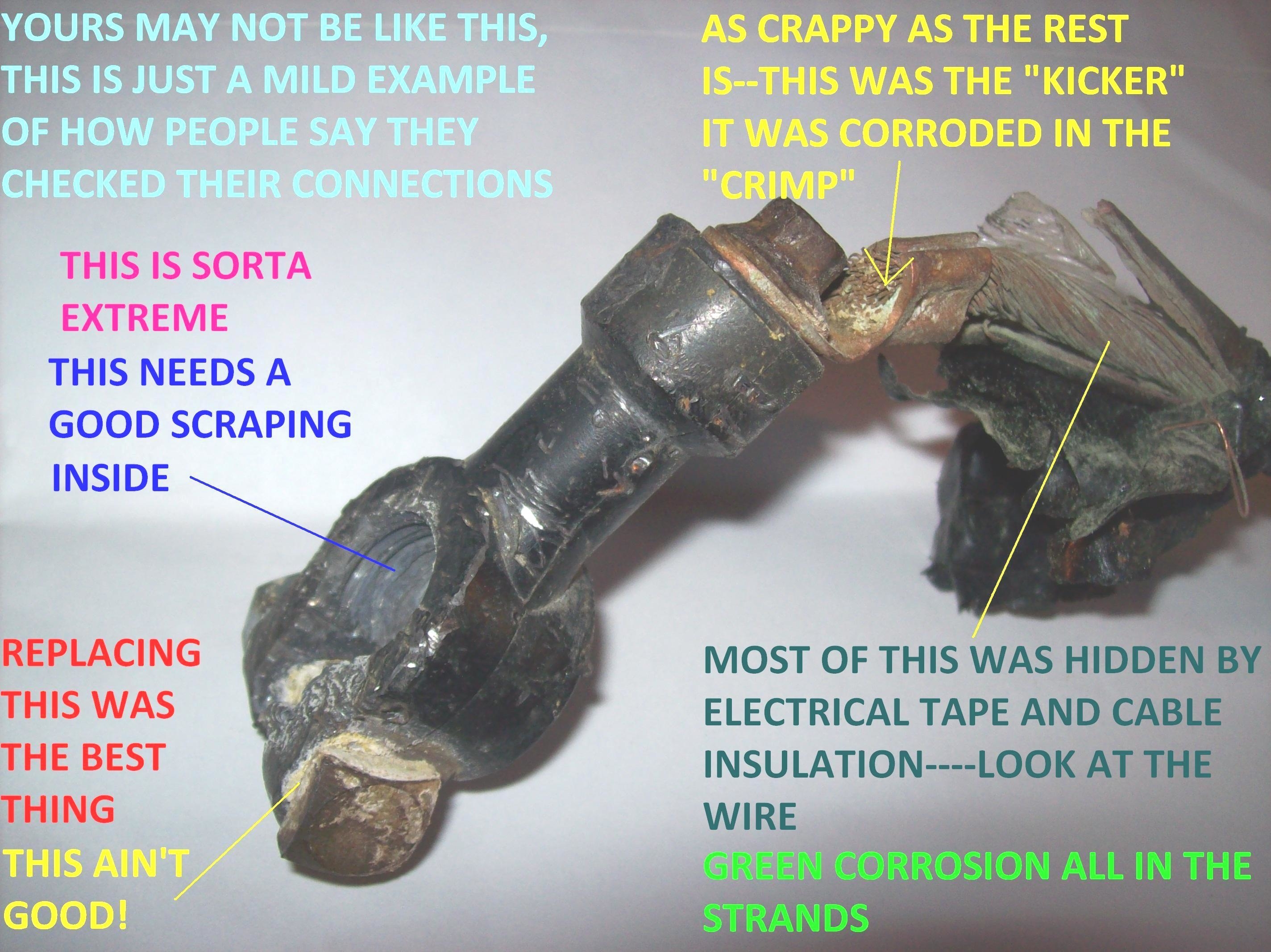

Sometimes your battery connections are corroded or just not tight enough due to not being fully seated or the nut/ bolt is bottomed out or broken off. If you can move them bare-handed they are too loose.
