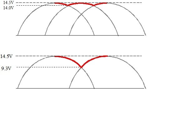

I put this drawing together to show what ripple voltage is. That's the red line in the top drawing. Every AC generator, (technically, "alternator" is a Chrysler term), has at least six "diodes". Those are one-way valves for electrical current flow. If all six are good, you'll get the top waveform, and under test, this is the only time the alternator will develop the maximum current it is designed for. You can find the listings on the Rock Auto web site, but I'd be pretty sure yours is rated for at least 120 amps.
When one diode has failed, you'll get the lower waveform in my sad drawing. Ripple voltage here is "high" and will be shown as such with a series of flashing lights on most testers. The other symptom is the alternator will only be able to develop exactly one third of its rated current. That can be enough to keep the engine running, but it's usually not enough to meet the demands of the entire electrical system and charge the battery. The battery will have to make up the difference as it slowly runs down over days or weeks. High ripple voltage also commonly shows up as an irritating whine on AM radio, that changes pitch with changes in engine speed.
