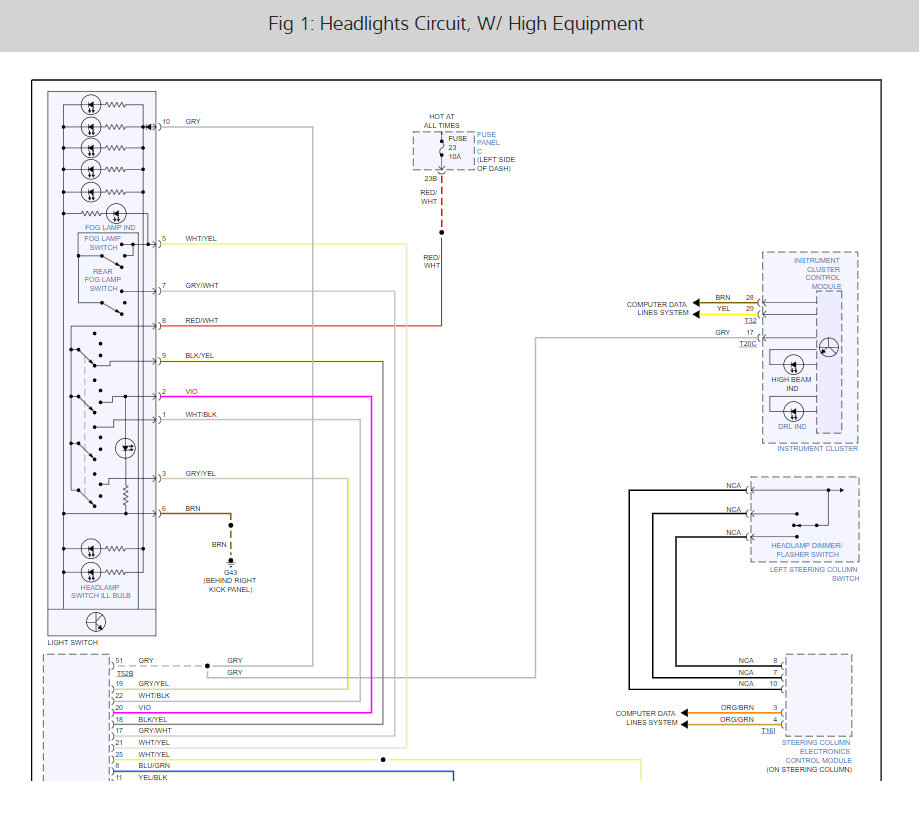

Does the right side work? If it does, then we need to check for power at the light socket. You can do this with a test light. First, here are a few links that show how to use basic testing equipment:

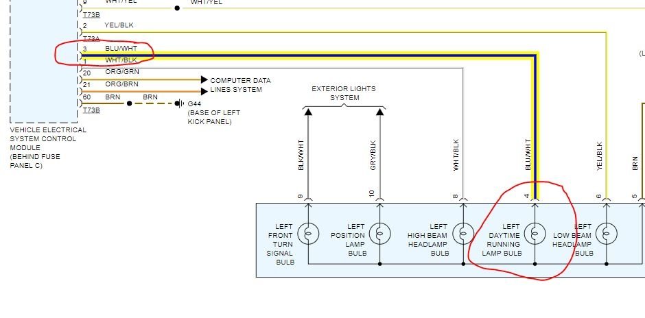

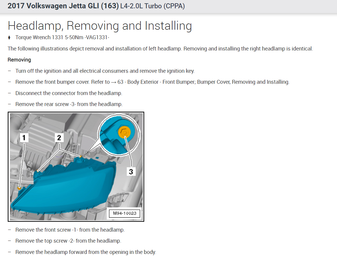

Now, I attached a picture below of the light in question. I need you to check if there is power to the blue wire in the pic. Then, I need you to check if there is continuity to ground to the other wire. If you find there is power to the blue wire, then the problem is no ground because you already tried a different light socket.
If there is no power to the blue wire, then we need to trace it back to the power supply, the control module behind fuse panel C.

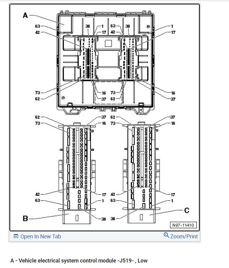

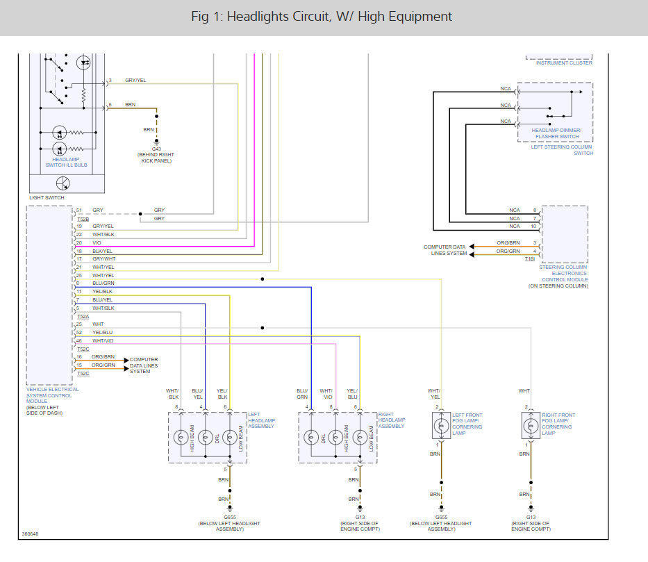

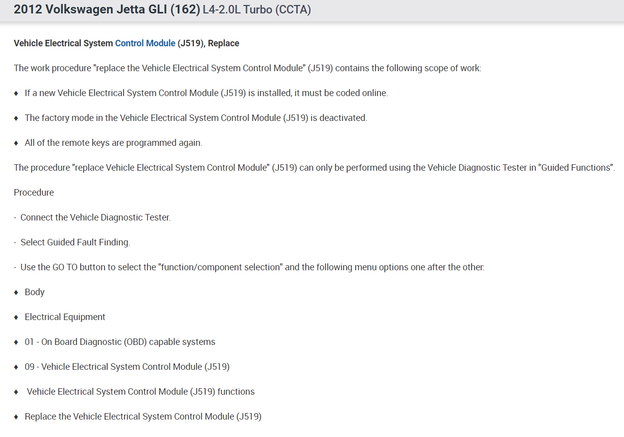

Actually, if I was doing this and found no power, I would first check the control module first to see if that is where the problem is. If there is power there, then I would know the wire between that point and the light is bad. Now, the reason I asked if the right one works is because power also comes from the control module. If you look at pic 2, I circled both power supplies to the left and right. Sorry for the sloppy letters.
Check for power and let me know what you find. Also, if you have other questions or need help, let me know.
