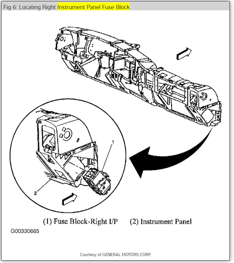

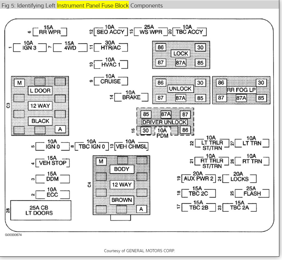

Day time driving light does not come on after I replaced a socket and a bulb on passenger side.
Jun 22, 2018 at 5:49 AM
CERTIFIED EXPERT
53,855 POSTS
I would remove the bulb and double check to see if it is the correct one because it sounds like you blew a fuse. Here are two guides that can help us:
https://www.2carpros.com/articles/drl-light-bulb-replacement
and
Here is the fuse location check out the diagrams (below). Please let us know what you find.
