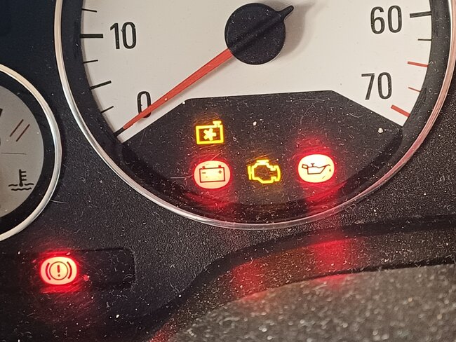

Car just started to give problems. What do these lights mean? It won't start.

That depends. If you see them right after you turn on the key, that is "bulb test" and it turns them all on as a test to be sure they all work. Normally the charge (battery symbol) the CEL and oil (right light) all go out once the engine is running. The little fan symbol is to do with the cooling fans on the radiator and the light at the far left looks to be the brake warning light. What does it do when you try to start it? Lights come on but nothing else. You hear a click, or the starter tries to turn over the engine, but it doesn't turn? Or does it start turning over but doesn't actually start running?

Good day, the car with spanner warning light is on when i turn the key, but flashes when i try to start the car.
Someone told me the ECU lost its memory and needs to go for coding. Can that be the problem?

Okay, that sounds like the security system is active. Usually, the flashing means it isn't detecting a good or valid key. I would try a second key first. If that doesn't work, then you would need to use a scan tool to read the fault or have a mobile locksmith try making a key to test. Both methods can be expensive.
