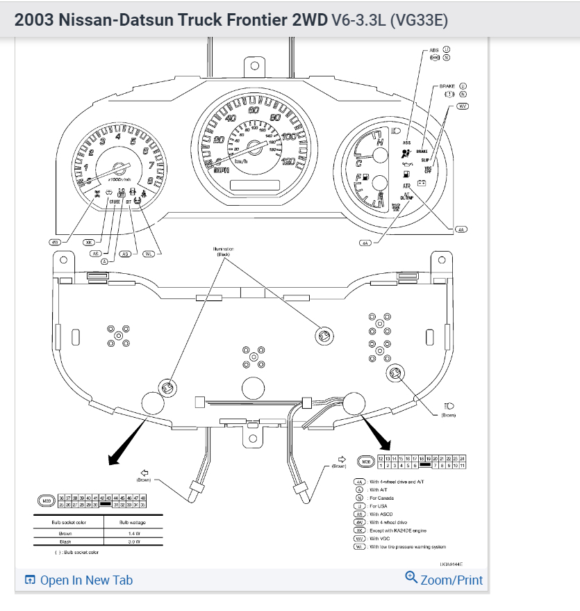

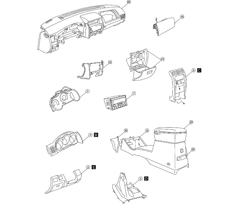

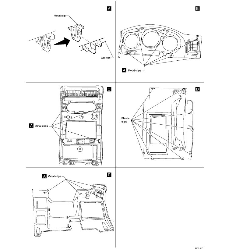

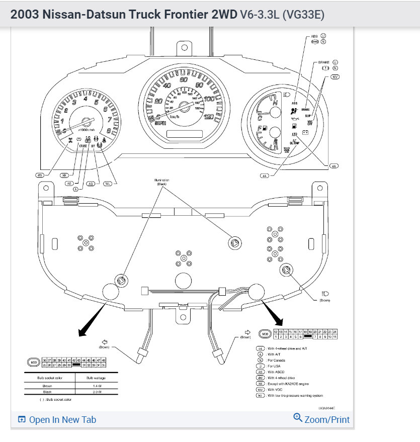

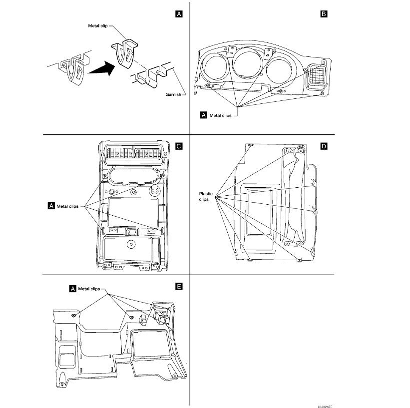

Yep, the instrument cluster does not like water. I would remove it and get a rebuilt unit. here is how to do the job in the images below. Let us know what happens and please upload pictures or videos of the problem. You can find a rebuilt unit by searching Google or Ebay.

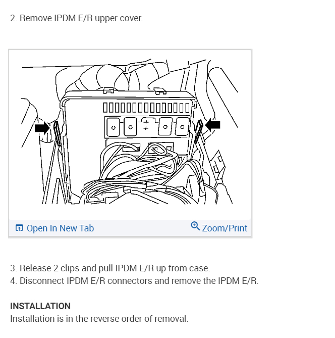

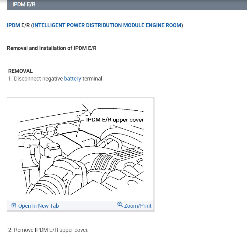

Okay, so it sounds like the IPDM is out or still wet, it is solid state and does not like water, I would try to dry it out here is the location of the IPDM, disconnect the battery first and let me know how it goes. Check out the images (below). Please let us know what happens.
