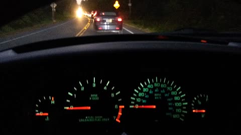

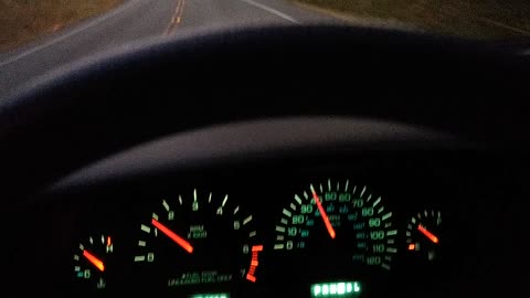

MGPETRYK
showing dashboard before and after a slap.
Sep 26, 2022 at 1:56 PM
CARADIODOC
  • 34,306 POSTS
Don't waste your time with an over-involved diagnosis. There are broken solder connections on the instrument cluster's connector. Two rows of pins. Most commonly broken connections occur on those pins on the ends of a row.
