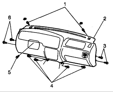

Remove screw attaching left side of instrument panel support beam to instrument panel. Remove screw on bottom left side of instrument panel.
Remove instrument panel support beam covers and bolts.
Remove two instrument panel screws from bottom of glove box opening.
Remove front speaker grilles and instrument panel upper center cover with a screwdriver. Remove three upper instrument panel screws.
Pull instrument panel from support member and remove from vehicle.

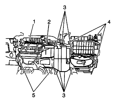

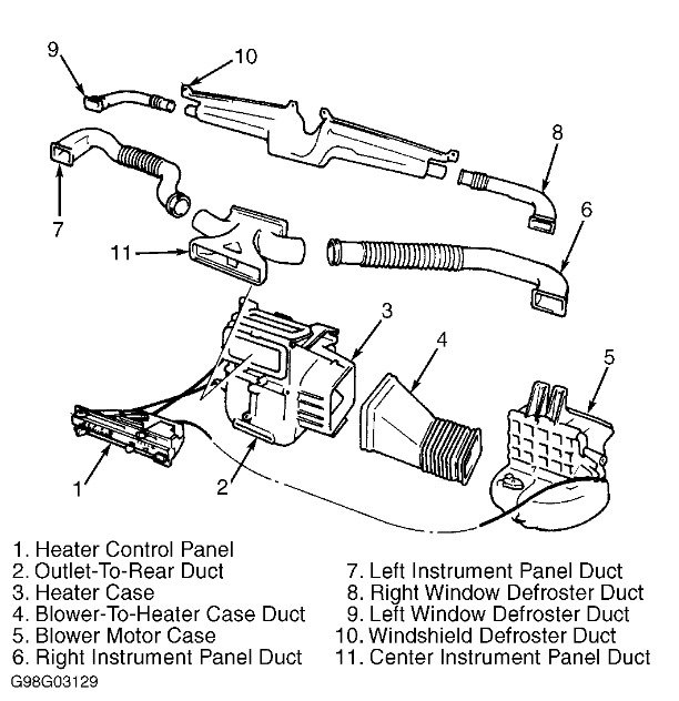

Heater Core Removal Procedure
Drain the engine cooling system.
Remove the Instrument Panel (IP) carrier.
Remove the heater hoses and clamps from the heater core.
Disconnect the electrical connector from the A/C compressor control module, if equipped.
Remove the A/C compressor control module (2), if equipped.
Remove the two nuts and six screws (three) from the air box.
Remove the air box from the vehicle. If equipped with A/C, remove the evaporator after recovering the refrigerant.
Remove the nut from the center of the bulkhead on the engine side (1).
Remove the two nuts from the heater case (two).
Separate the floor ducts from the heater case.
Remove the heater case from the vehicle.

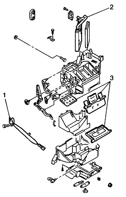

Disassembly Procedure
Remove the eight heater case retaining clips.
Remove the screw and the blend door linkages.
Separate the heater case halves.
Remove and replace the following components as necessary:
The defrost switch
The blend doors
The heater core
The linkages
