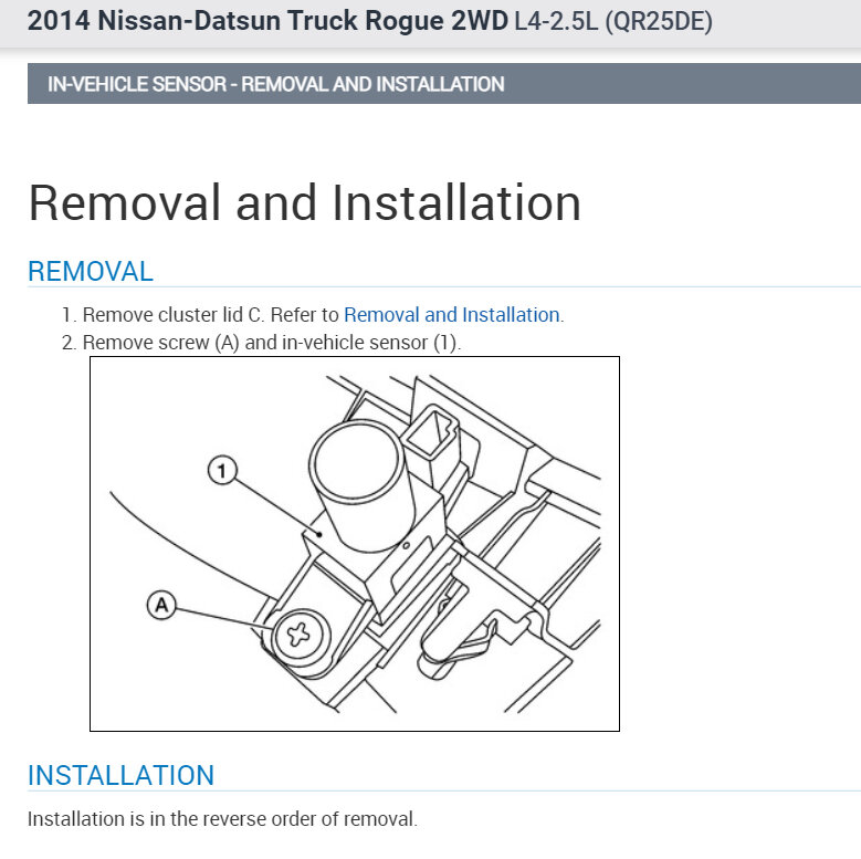

Why would the outside temperature light be flashing on the dashboard?
Dec 24, 2022 at 5:19 AM
JOSEPH STORTZ
Dec 24, 2022 at 5:57 AM

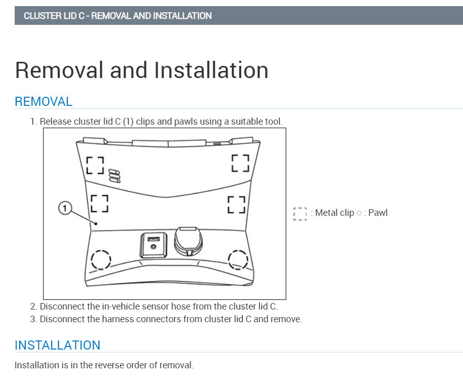

This means there is no input from the temperature sensor, or it is not hooked up. Here is the location so you can check it out. Check out the images (below). Please let us know what happens.
