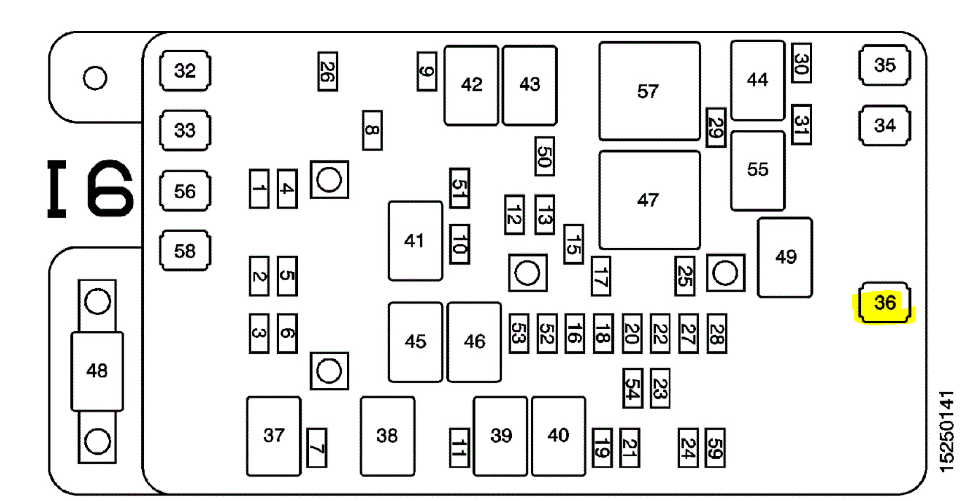

There is a chance that a fuse has failed. Do me a favor. I looked through the wiring schematics and noted that power for the items you mentioned originates at fuse 36 (ign B) fuse in the under-hood fuse box. I need you to locate the fuse and check to see if it is good. In addition to checking the fuse, I need you to confirm there is power to and from it.
Additionally, if you look below, I attached a pic of the under-hood fuse box and highlighted the fuse to check.
See pic below.

I did look at those and they are fine. I've got nothing on my dash for lights, no radio, windows or taillights. This happened after I had to unplug my battery.

The idea that you lost all of these at the same time is likely a fuse. In addition to checking the fuses, did you confirm there is power to them? These circuits depend on a series of fuses. We need to determine where power is lost so we can identify the fuse before that point which is likely the cause.
Let me know if you have already checked for power to all fuses related to the affected components.
