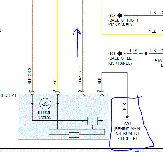

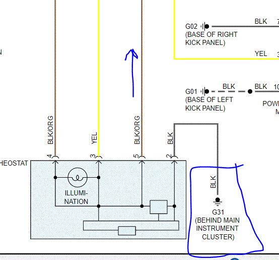

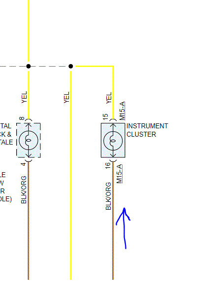

Since they work at times, then we know it isn't a fuse related issue. So, either we have a weak connection at the instrument cluster or a weak ground.
If you look at the attached pics, they show power (via a black/orange wire) to the instrument cluster. Also, it shows the rheostat ground for the lighting. What you need to do is first check to make sure the power supply to the instrument panel lighting is tight, not damaged, and in good condition. If it is, then we need to confirm a good ground under the dash.

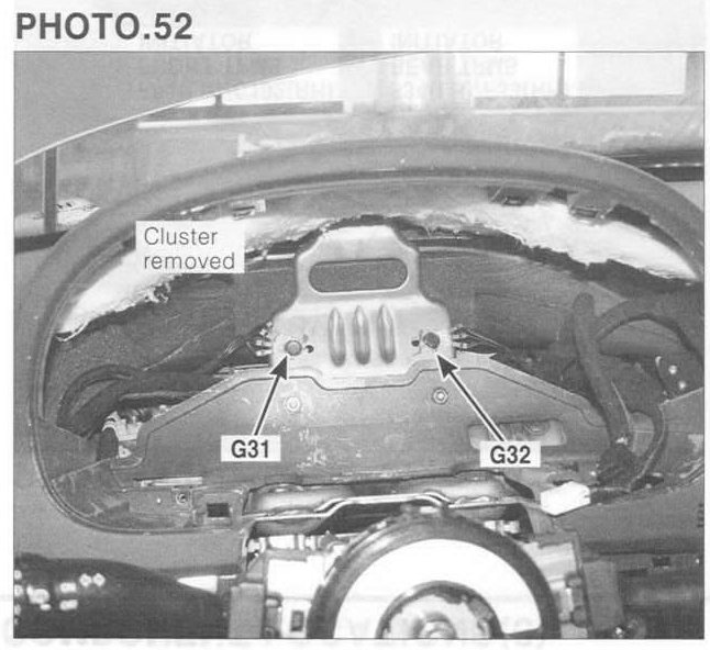

If you look at pic 3, it shows the physical ground location with the cluster removed. (G31)
