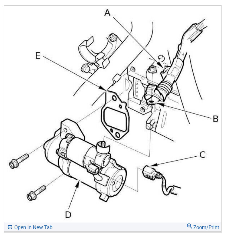

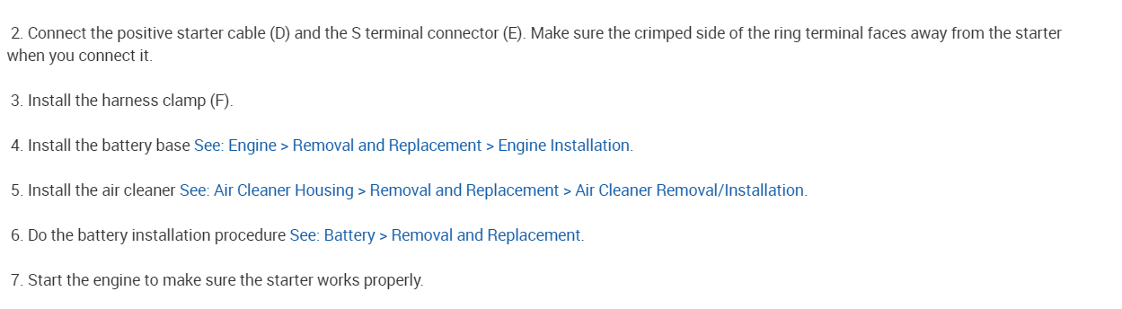

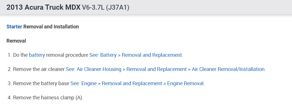

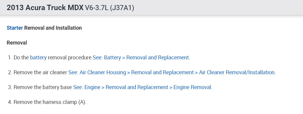

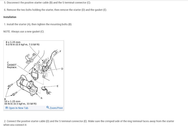

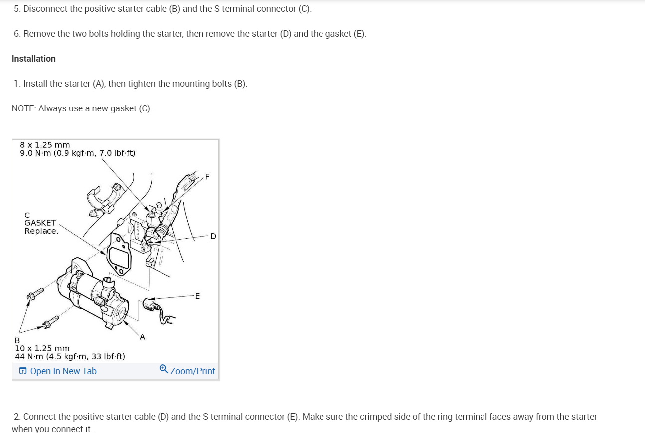

Yes, this sounds like you got a defective starter I would take it back and get another one. Also, make sure the battery cables and clean and tight. Here is a guide that can help also I have included how to change the starter motor out correctly in the images below.
