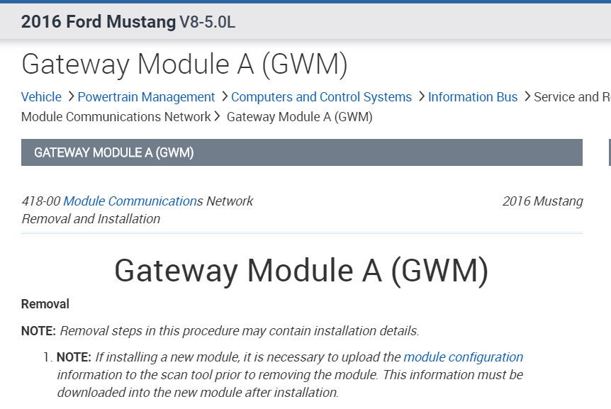

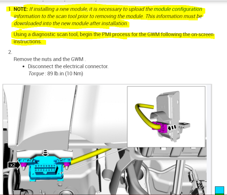

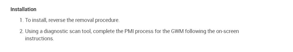

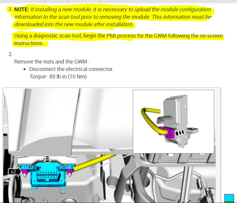

This sounds like you could have a problem with your vehicle's Gateway Module A or the HS CAN 3 network. In the diagrams down below I have included the factory instructions for the removal and installation of the Gateway Module A. It will require you to reprogram the module using Ford's Scan Tool. Please go through this guide and get back to us with how you proceed.
