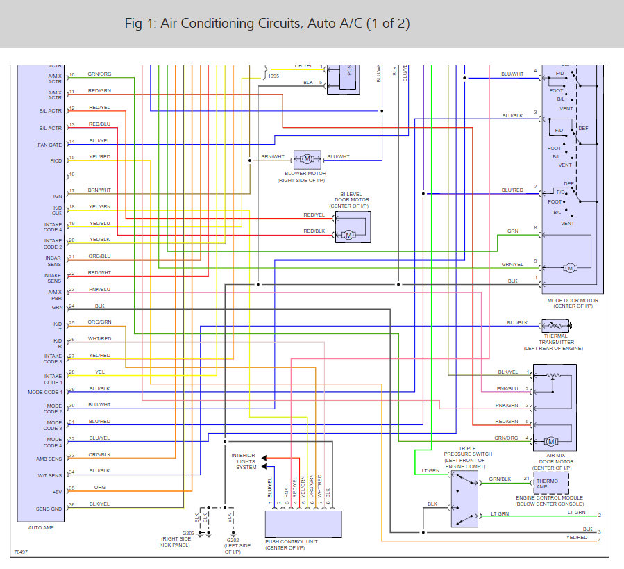

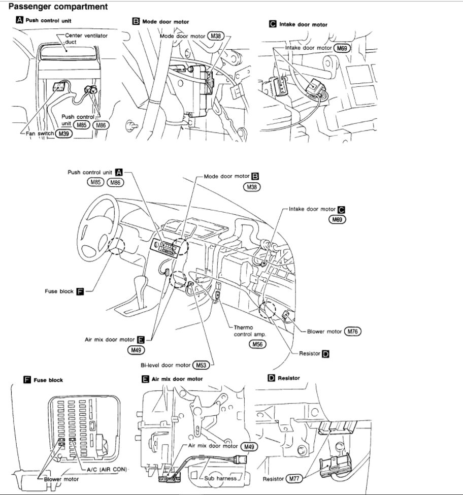

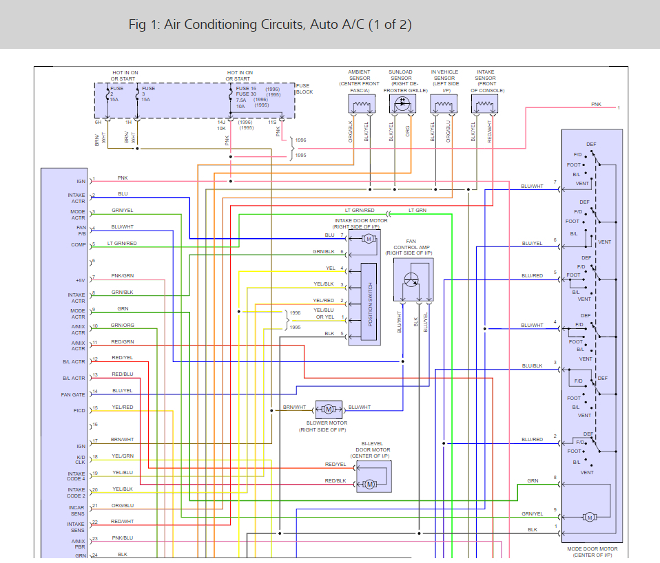

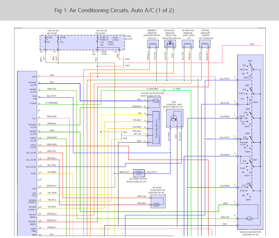

This sounds like you have a problem with the blower motor or the controller. Here is a guide to help us test and replace the blower motor:
https://www.2carpros.com/articles/blower-fan-motor-works-on-high-speed-only
Here are blower motor wiring diagrams so we can test for power loss:
Please run down these guides and diagrams and report back (below).
