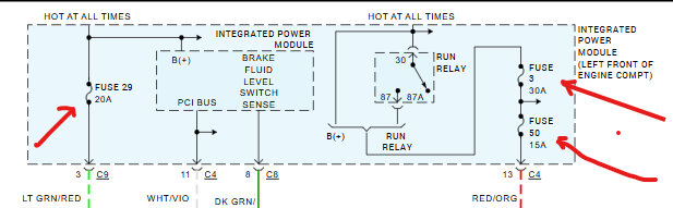

Yes, you can reset the cluster by doing a hard reboot of the system, here is a video to help.
https://www.youtube.com/watch?v=INiDRO5A5MY
But I would check the fuses that I have show you below use this video to help.
https://www.youtube.com/watch?v=G-xNK79Wa-w
Check out the images (below). Please let us know what happens. Ken
