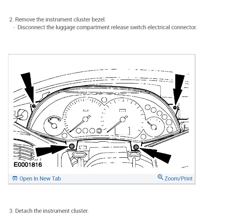

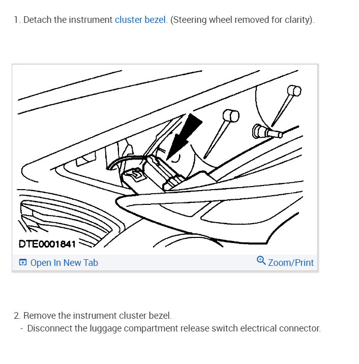

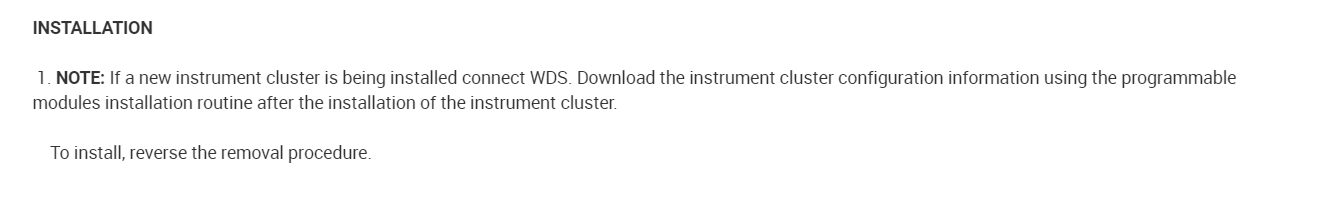

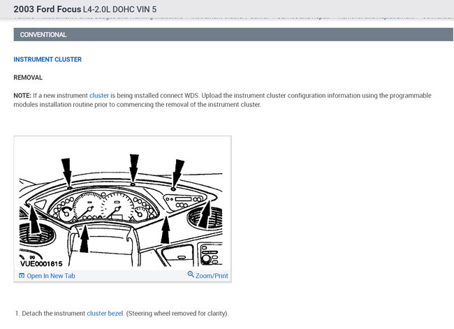

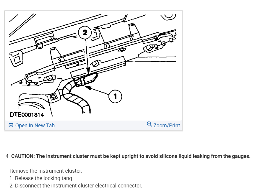

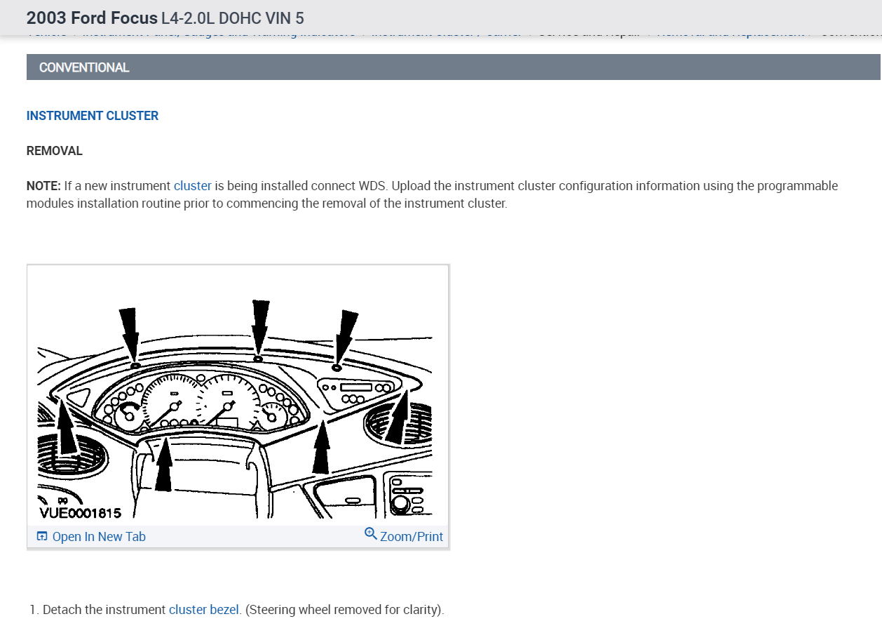

Yep, this happens when the instrument cluster goes out you will need to get a rebuilt unit by searching google or eBay. Here is how to change the unit out in the images below. Check out the images (below). Please let us know if you need anything else to get the problem fixed.
